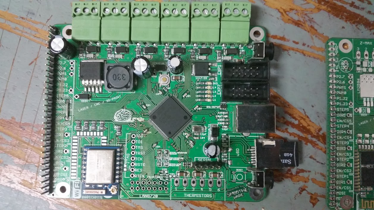

Can I start a print and disconnect / reconnect while it is printing with smoothieware [spoiler: YES but NOT with USB]? With +Peter van der Walt smoothiebrainz I could get rid of this nasty ethernet cable all through my house at last. I will not print via wifi (risky/unreliable), but I would love to upload a file, start printing, disconnect and check the process. Since I remember that part of octoprint was ported, is this right?
Oh, you already have one. Nice. I distinctly recall this particular green board with blue ESP. I think I’ve commented on it before.
@raykholo I wish I have one :slight_smile: Nope, I just was the guy who asked to use the remaining PCB location for optional BT and ESP modules :slight_smile: +Peter van der Walt yes, I know I already can upload, but I am unsure how it would behave if I drop the connection after starting the print.
