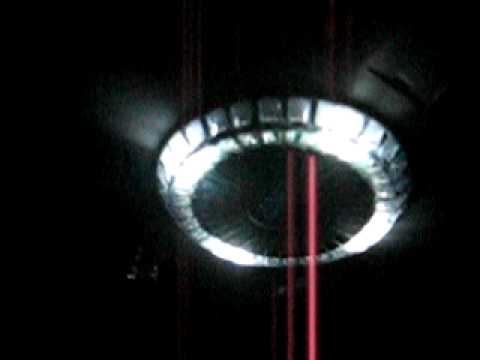

I have tried your sketch and only the first 9 out of 16 led’s light up.
I would like to make the led’s start at 0 and go to 16 and start over again in the color white, I know it is probably no big deal for some one that knows how to do this but its my first time using addressable LED’s and making sketch’s.
The data pin I’am using is #3 and my board is Mini Nano V3.0 ATmega328P 5V 16M Micro Controller Board Module Arduino.

is not the same as the video you showed us. The Larson scanner sketch goes back and forth (we call that Cylon), while the video goes round and round.
These are two different things.

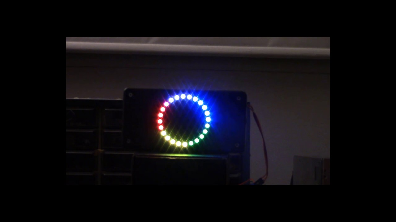

@Anx_Xna - You might want to look at my sketch at:
with a video of this sketch at:
Modifying this sketch using the color white and using the cd77_police_lights_one function should allow you to do what you are trying to accomplish.

@Anx_Xna - I have just posted a new sketch in GitHub Gist that contains only the function, cd77_police_lights_one_modified, from my original sketch, CD77_Police_Lights. It is located at:
Change the variables in line 38 to get the effects that you want.
