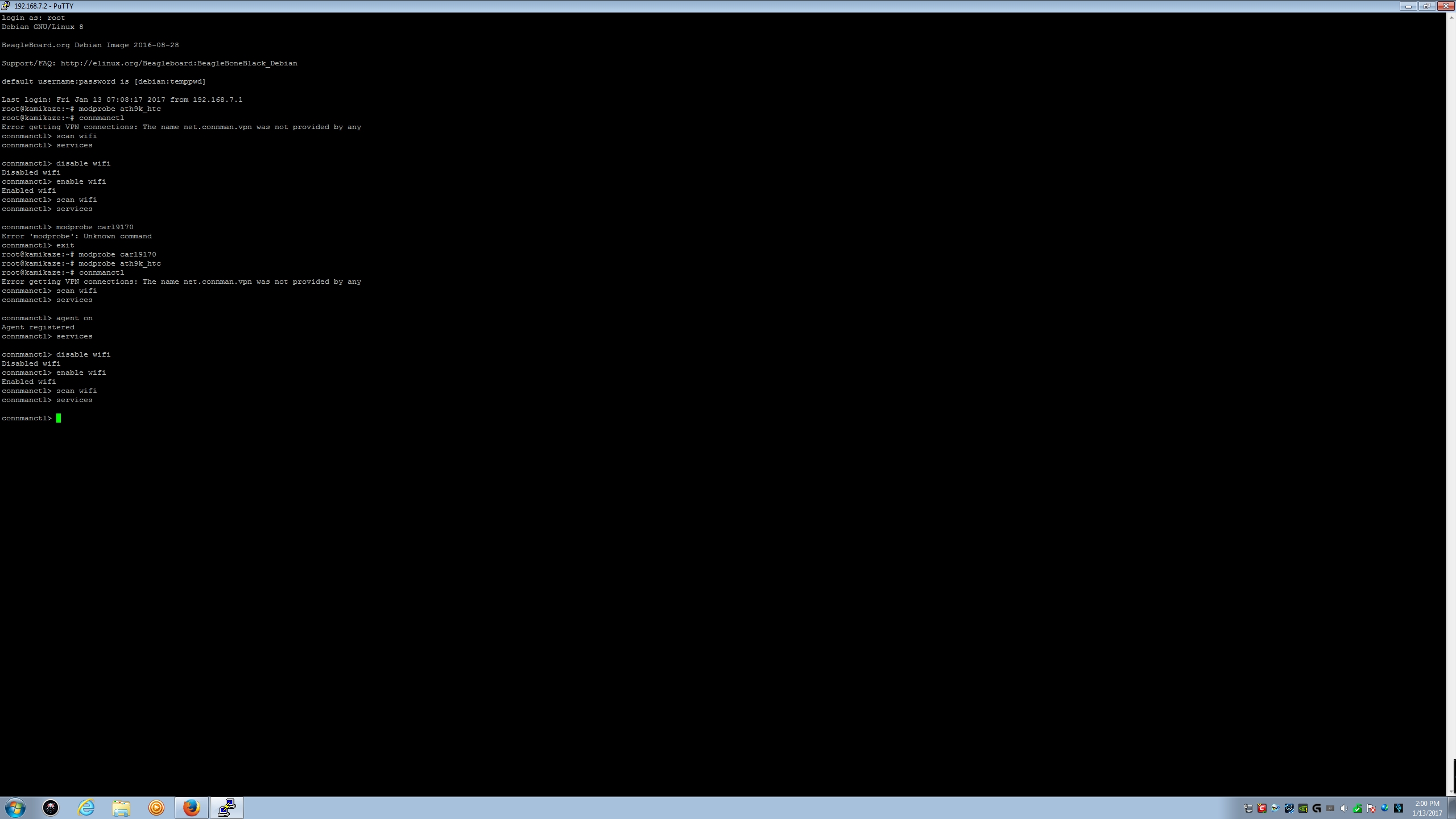

Secondly, im trying to go through the wifi steps in the wiki and that isn’t working at all. Even tho it wasn’t mentioned i did eventually figuer out i needed to type “connmanctl” first. however the first command after that does nothing. scan wifi does nothing, services does nothing, agent on DOES work. “connect wifi_dc85de828967_38303944616e69656c73_managed_psk” doesn’t work .
here’s a screenshot towards the end showing some of the commands

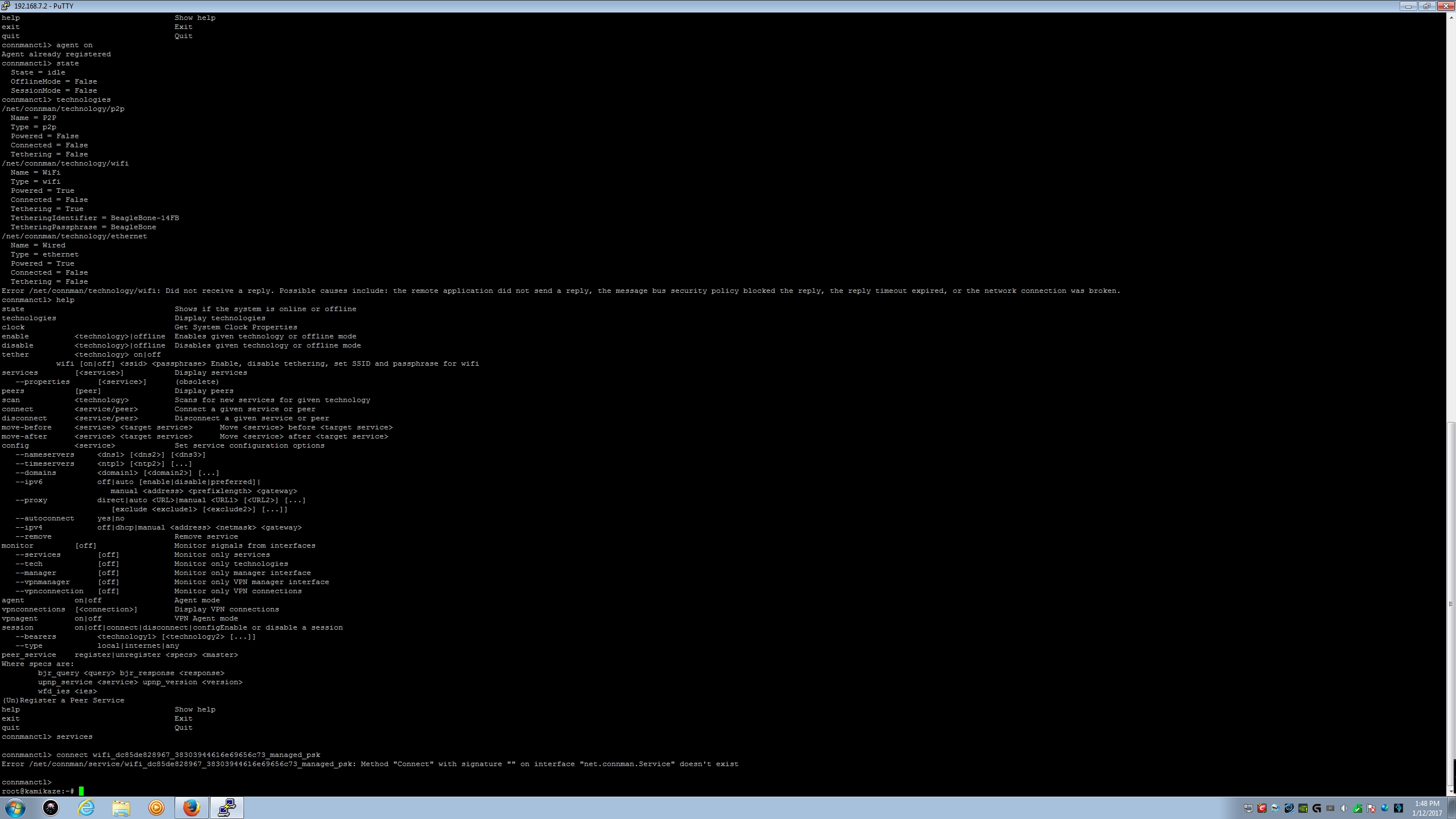

well here’s the terminal where i tried, nothing happened and this is after a fresh flash and apt-get update and upgrade. did i do something wrong trying to load them?
last night after alot of tinkering i did manage to get the ‘scan wifi’ to work, and when i tried to connect it asked for a passphase but it wouldn’t connect with the password. I wasn’t sure what i did to get it working that far so i decided to do the reflash and start from scratch because ill have to do this every time i update kamikaze.
basically what im thinking is the ath9k driver needed to be installed, and that let it work a little bit, but i have to get the ‘firmware’ part installed to really get it working and thats the part i don’t know how to do. Also isn’t there supposed to be a debian GUI? ive tried repeatedly to VNC into this and i keep getting a terminal instead of a GUI. i was going to try installing the wifi via the GUI :frowning:
maybe i should try the 2.1 version? or can someone walk me through getting the firmware file and putting it in the right folder? i can ftp into it but it wouldn’t let me modify files, maybe i needed ftp in as root.
