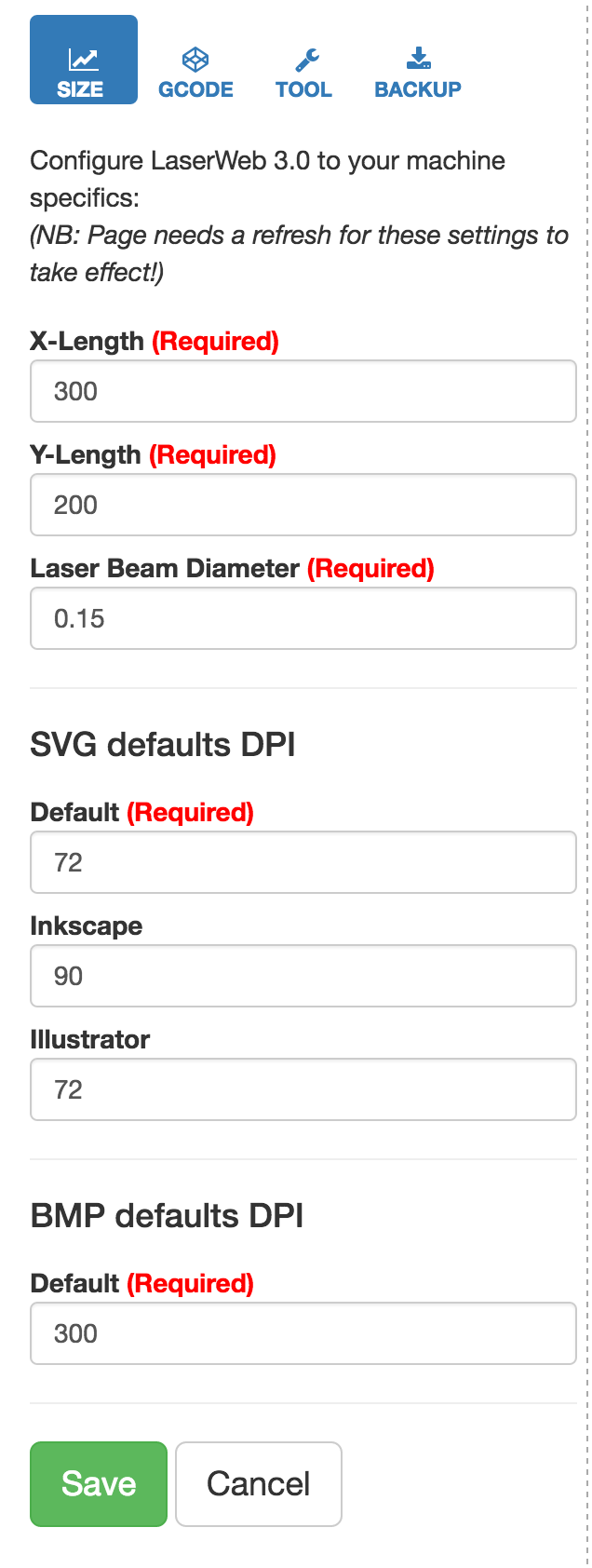

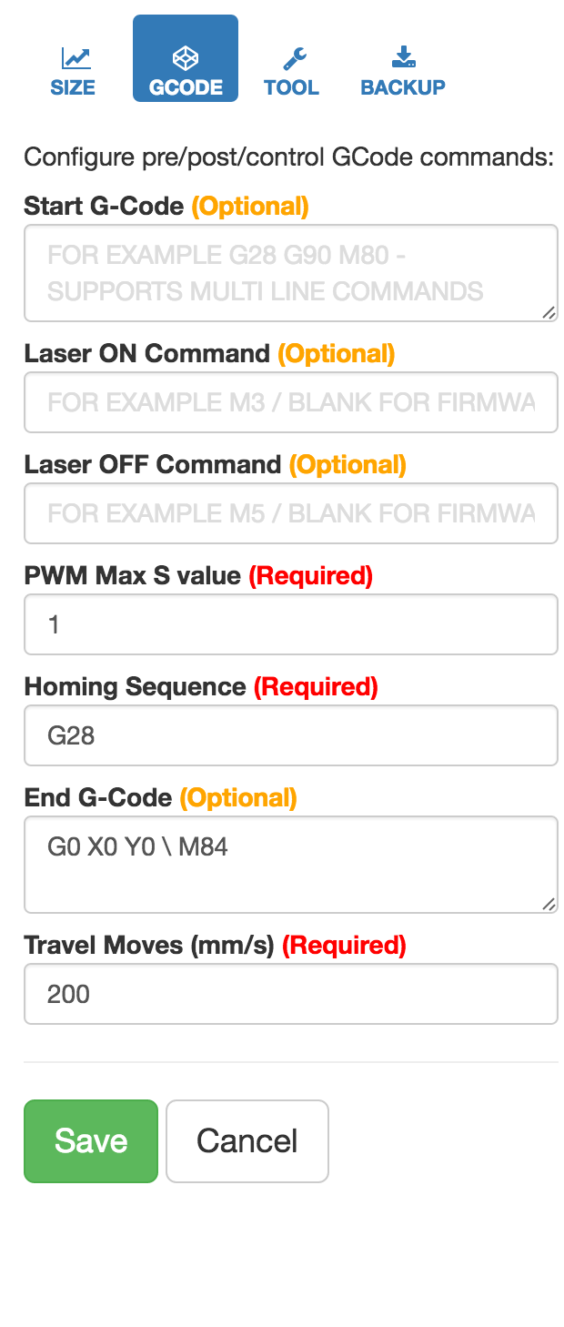

Can someone tell me what configurations are good to start with on Laserweb3 with
Can someone tell me what configurations are good to start with on Laserweb3 with a smoothieboard and k40?
Also what about the config file on the micro sd? Does this need to be adjusted?
Setting in LW are very straightforward, bellow image of mine
here is the link to my config. Please read on that thread regarding stepper motors https://plus.google.com/+ArielYahni/posts/Riexg5WHVs6
