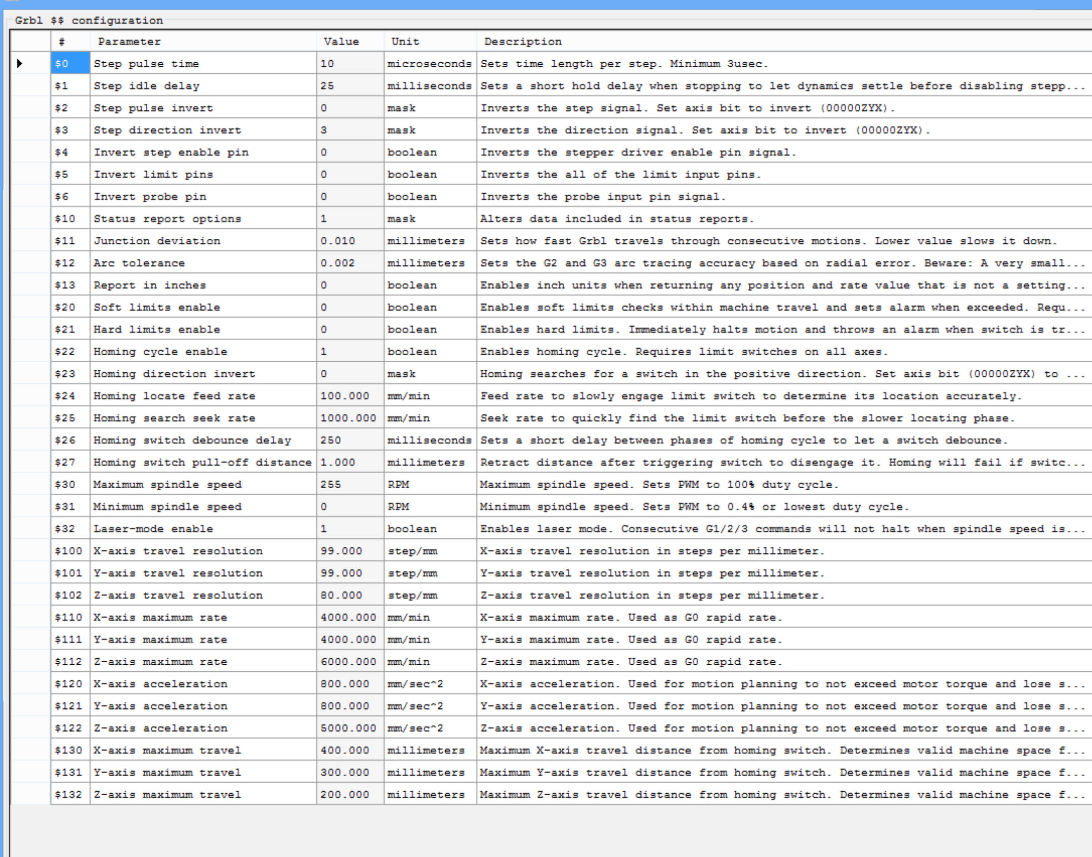

Hello Roberto. It is a Laseraxe 7W machine using an arduino board flashed to 1.1f firmware. I’ve also attached a screenshot of my grill settings . Many thanks for your help. Paul

I think I may have sorted it Claudio. Searching round, I saw that $$01, if it was set at 255 kept it running smoothly. I changed that and it does indeed seem to have done the job. For some reason though, the settings that I had for photographs have gone to pot and I am having to work them out again. Wouldn’t it be nice if one setting suited all materials? Many thanks again for your help Claudio, I do really appreciate it. Kindest regards Paul
