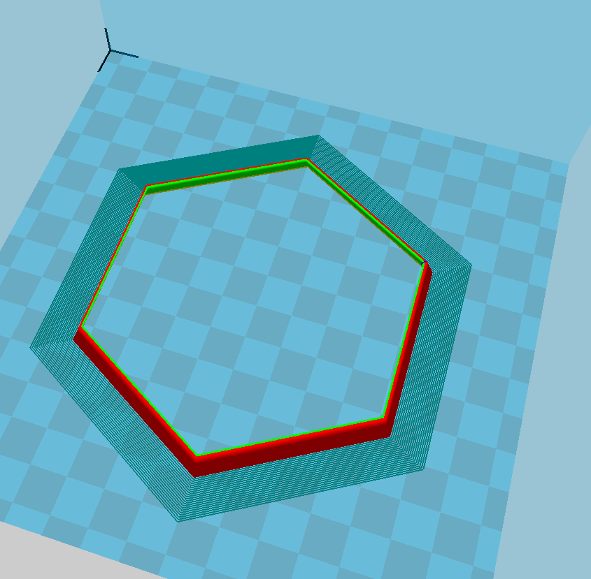

Can someone tell me what tha f*** is happening? When I export a solid object from Google Sketchup to cura, it creates walls and deletes some of the mesh. For example here, it adds a bottom piece and delets the magnet holes I created. In much need of help!
Exporting from SketchUp is whacky and does weird stuff if there’s the slightest issue with your model. Go back to the model and look around to see if there’s any weird lighting issues, that means that something isn’t a solid.

Im gonna switch from Sketchup, but then I would have to learn a hole new program… I have redone the hole object by “painting” over the old object, and fixed all the issues i could see. (I saw one) But the problem persits, only the problem is somewere else. What program should i use insted? I would like to go bigtime if I would to switch program, is Cad the way to go?
You can use netfabb to repair it first and that works. Would still recommend using a different modeling program though. I recommend Fusion 360

Are you sure that spiral wase is not active?
What do you mean by “active”?

@Alexander_Frisk I have done a fair bit of design with SketchUp. It has this funny little habbit of making incomplete lines. It is extremely picky about how you draw the part in order to keep it solid for STL export. How fast do you need this done? If you want a working STL file like say in about a couple of hours. I am willing to remake the file for you. Would need all the nessecary dimensions. If interested, message me on Google Hangouts. The link is in my profile.
Well it says
a) there is no solid and
b) there are a bunch of ungrouped edges.
Grouped them and you’re a step further. :slight_smile:

There is a few add ons you can get to sort it out.
My fav is
solid inspector.
Then get clean up. Both by the same bloke.
http://extensions.sketchup.com/en/content/solid-inspector²
http://extensions.sketchup.com/sv/content/cleanup³
You can always put your Models into 3d builder to fix them. I once made a magic penholder and the files were made wth SketchUp. They were totally broken when I downloaded them. 3d builder fixed them perfectly. I would also recommend that you use fusion360. It is the perfect program for me.
