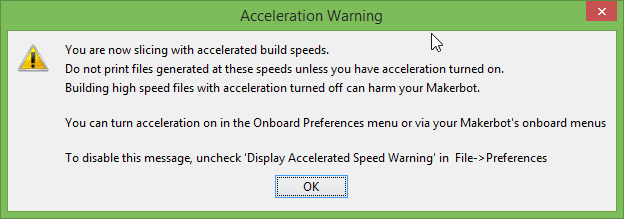

Can someone tell me what this scary message is all about and what is the best way to handle it? I get this message when generating gcode with ReplicatorG. My printer is a Monoprice Flashforge Creator X clone. What is Acceleration? Should I use it? Is this message meaninful? Will I somehow damage my printer as it states? Thanks for any help you can provide.

@Tim_Odell : yes, you want acceleration. The term just (mostly) means that the firmware on the machine understands that changes in speed don’t happen instantly - you have to ramp up (or down) to the target speed. Doing this well can mean a big increase in how fast you can print and in quality.
This is so common now that most people will be surprised that it can be turned off or that some machines may not always use it. I’d run away from repg and use more common stuff, if you can…
Back when RepG was being actively developed, lots of people ran printers at constant speed. Acceleration lets the printer speed up on straights and slow down at corners. Since turning corners must be done at low speeds, acceleration lets you use higher target speeds than not using acceleration. HOWEVER, back when RepG was new, there were various bugs and issues with acceleration, so many people didn’t use it. So it was very reasonable to warn people if their chosen speeds were too fast for non-accelerated printers to do safely.
