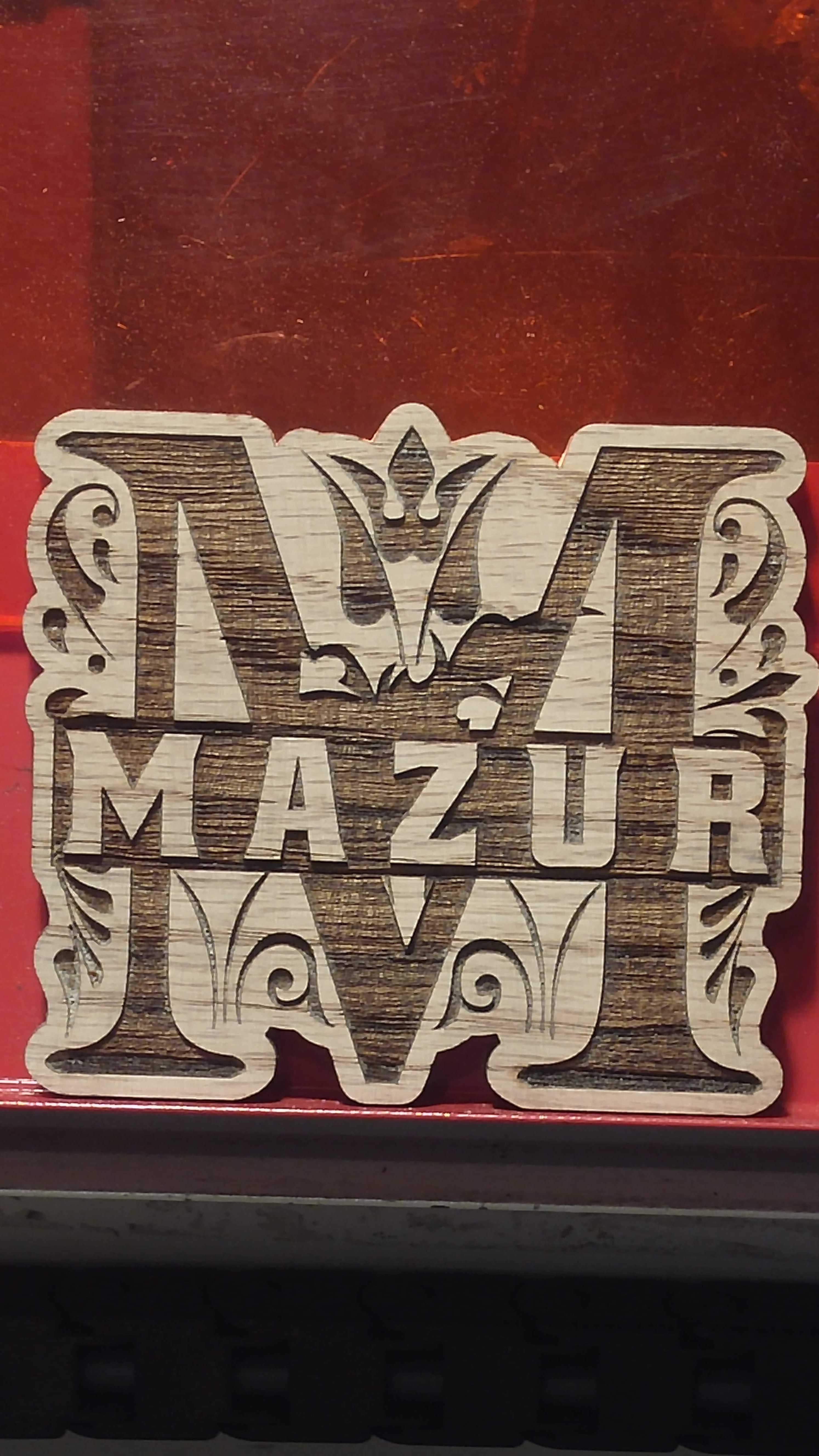

+Don Kleinschnitz Jr. Hard to do stuff with a table saw you can do with the K40. I’m going to start making good sized house markers etc. with the 1/2". This example is 1/4" oak.
