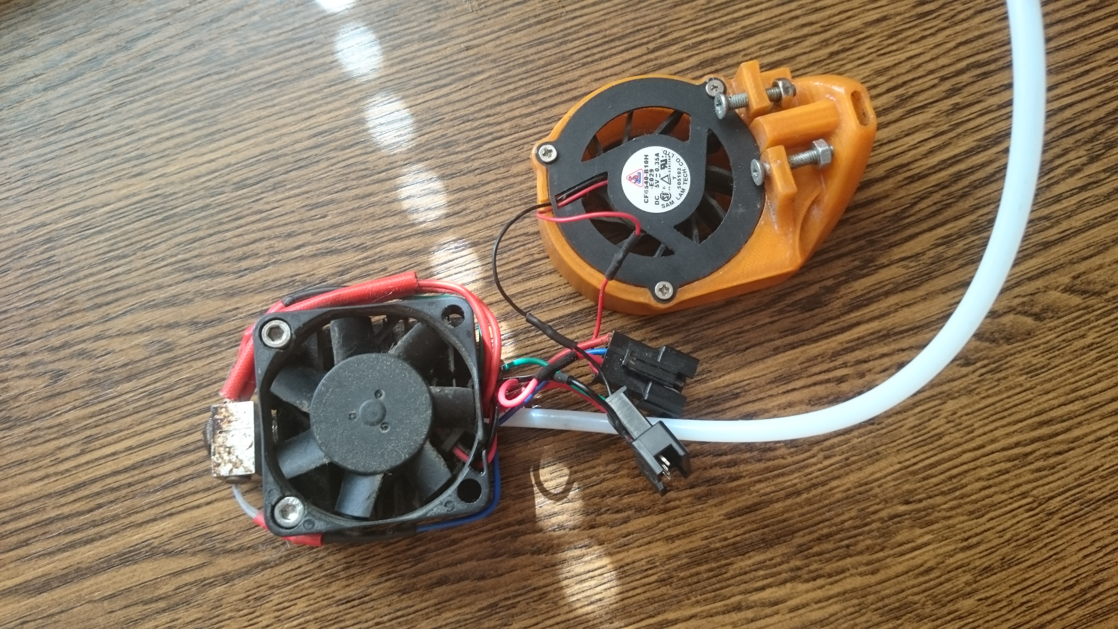

Can you suggest a small enough, reliable, motion-resistant connector, preferably with a fixator?
Can you suggest a small enough, reliable, motion-resistant connector, preferably with a fixator? I encounter the problem that with the round-the-clock operation of printers, sooner or later the contacts of the print head begin to be badly contiguous. I understand that the best way is to solder the wires directly to the printhead elements, and use the connector only on the controller side. But I still want to make it possible to replace the printhead without a cable. Interested in connectors for 2,6,8 contacts.
