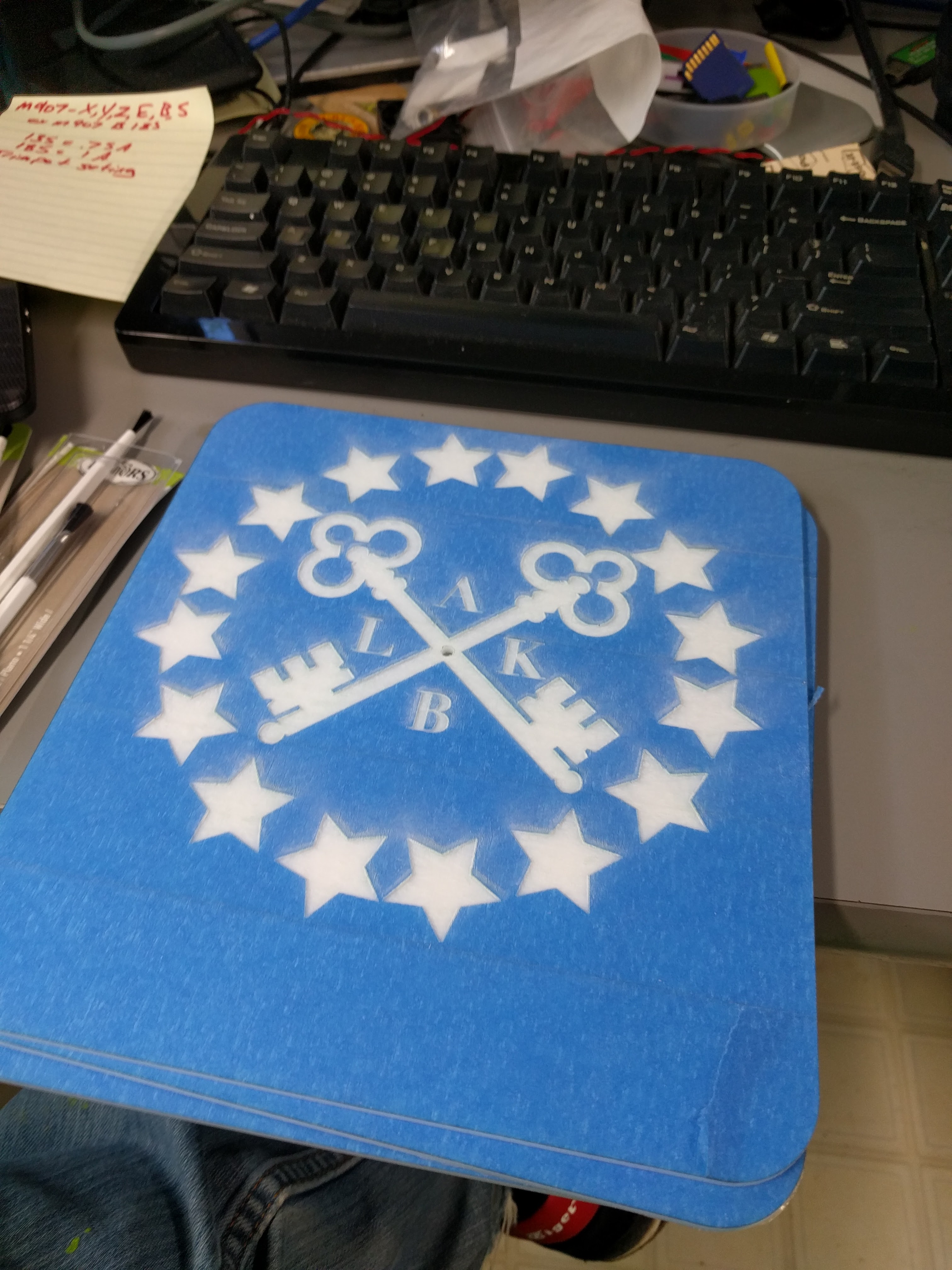

This is blue tape on white acrylic. I dont like leaving the plastic film on extruded acrylic. It tends to melt into hard to remove balls and the edges can be really hard to peel up. This burned off really cleanly and I have yet to have an issue with it on any material I’ve tried.

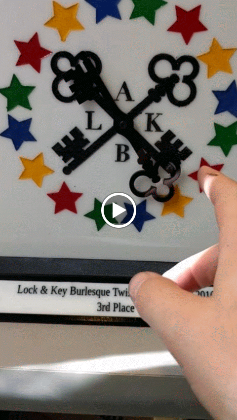

This is the finished product. Color filled with Testors enamel. I left the blue tape on for the fill process and then used 90% isopropyl to remove any excess or bleeding on the edges.
