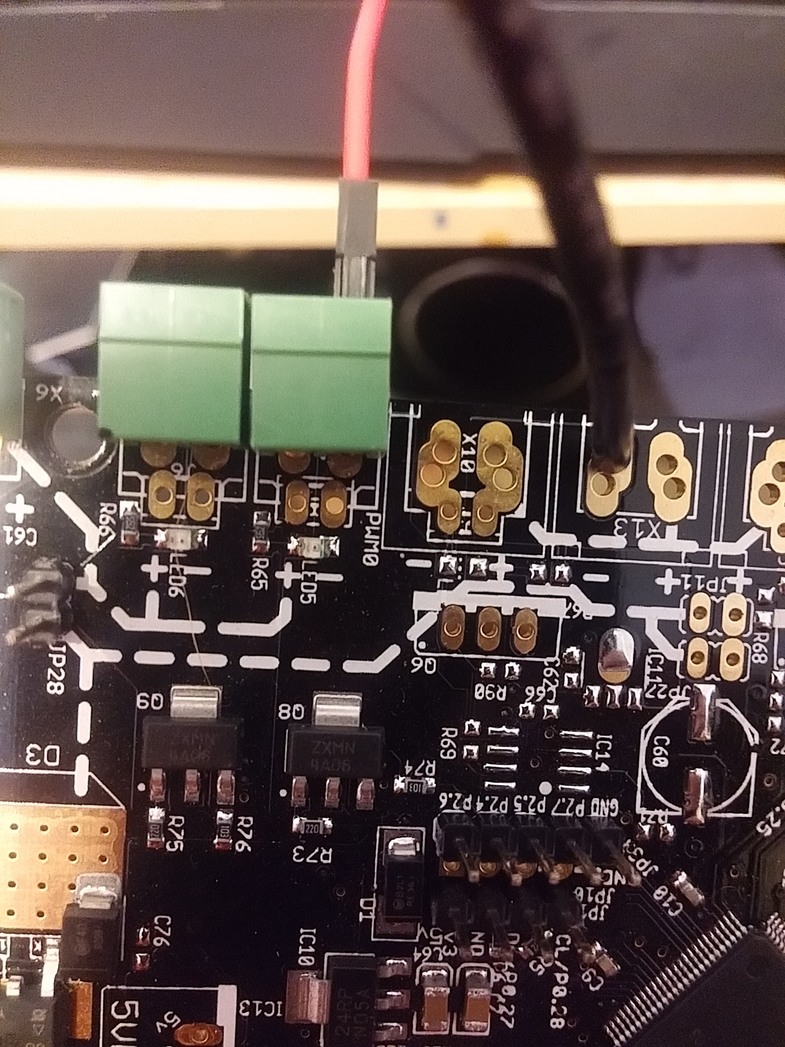

Im still running ground with the 24v in on VBB, correct?
@Jerry_Hartmann yes the 24V and grnd does not change, this is just the PWM and its signal ground. Did you verify with a DVM that the black wire is grnd ?

@donkjr laser module pin was already 2.4 while using the leveler. Do you mean switch.laserfire.output_pin ?
Ok, so neat, it fires without the leveller. I copied your config onto the sd and it will attempt to engrave but it still does so at max power
@Jerry_Hartmann you only need one port P2.4, I I have laser-fire disabled.
