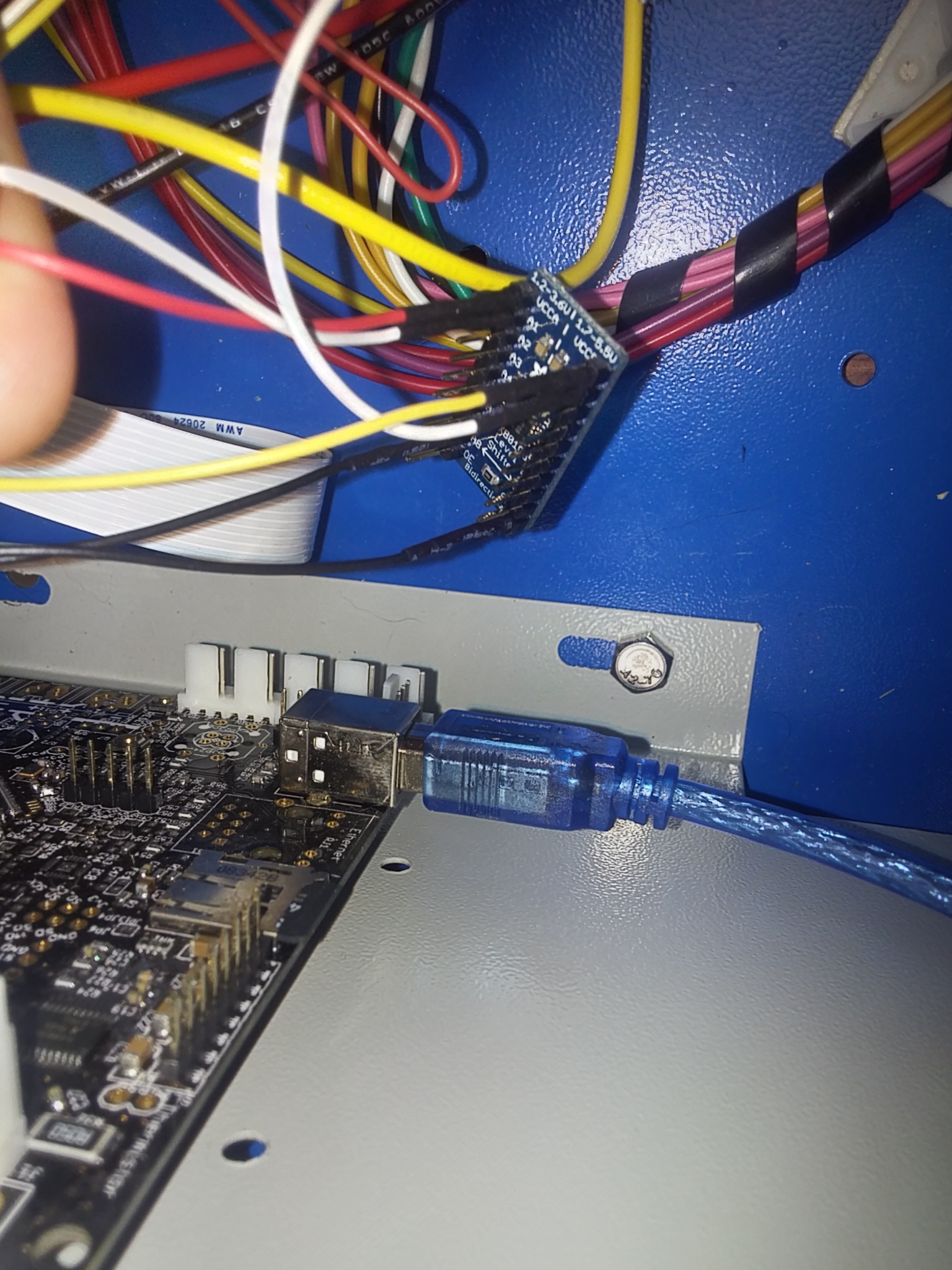

Cannot seem to get PWM control. 2.4 (White) and 3.3 (red) are VCCA, Laser on LPS (White) and 5v (Yellow). I always get 100%.

I need to better understand exactly how you connected your PWM. It looks like in the picture you are using a level shifter? A level shifter is not needed.

@donkjr The laser wouldn’t fire until @Scott_Marshall helped me set up the leveller.
@Domm434 That schematic is for the 5x. I’m using a 3x. My PS looks different as well.
Let me make sure I understand. I have a GGGG. I disconnect the leveller. I don’t use 2.4 or 3.3 and simply connect PWM0 to L?

@Jerry_Hartmann this should be straightforward. The blog post sited above applies to your 3x board.
The P2.4 (PWM) connector is populated just like the 5X picture (white wire).
The connector that is used for ground (black wire) in that scheme is not populated in the 5x but you can pick up the ground right off of X13 on board where the connector would have been installed.
The attached layout graphic shows more detail.
Verify your ground with a DVM to be sure you have the right pad.
If you wire it up as this suggests and post a picture before trying I will check it for you.
Note: you have to change the configuration file to match this setup (P2.4).
