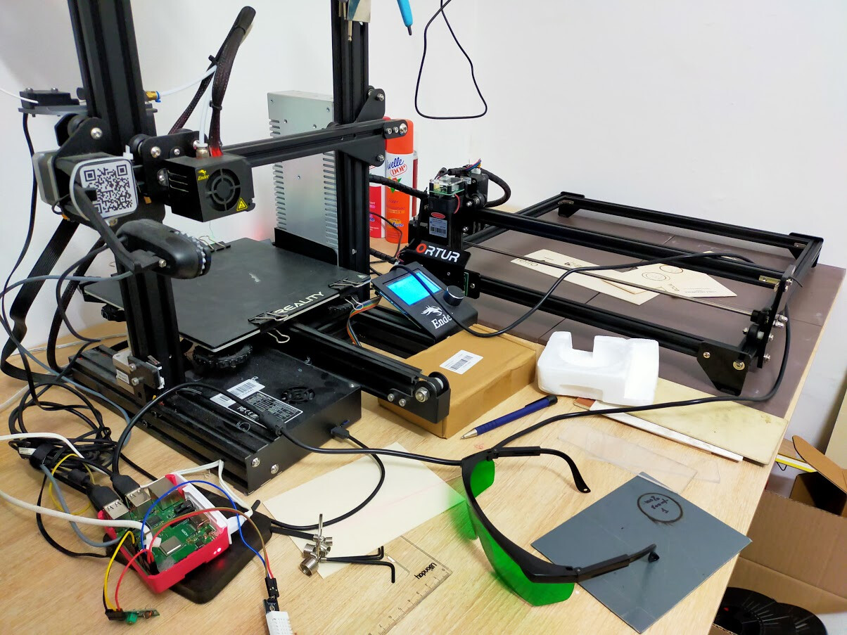

here is my setup. I can now controll my 3D printer (via octoprint), my ortur LaserMaser2 (via LaserWeb) and other stuff from my RPI3 server.
thanks @cprezzi
