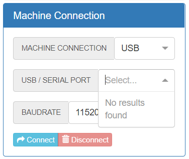

But when I attempt to connect to the machine, the port is not detected and I cannot select any port for my USB connexion.

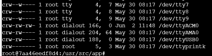

with LaserWeb running, open a console on that Docker image and show the long listing( ls -l ) of the /dev/ttyACM0 device and then run a process listing to show what owner is running the laserweb daemon( ps -fe | grep -i laserweb )
here are the commands you asked from within the laserweb docker container.
You got me, it sure looks correct so I would expect the laserweb server to find the device.

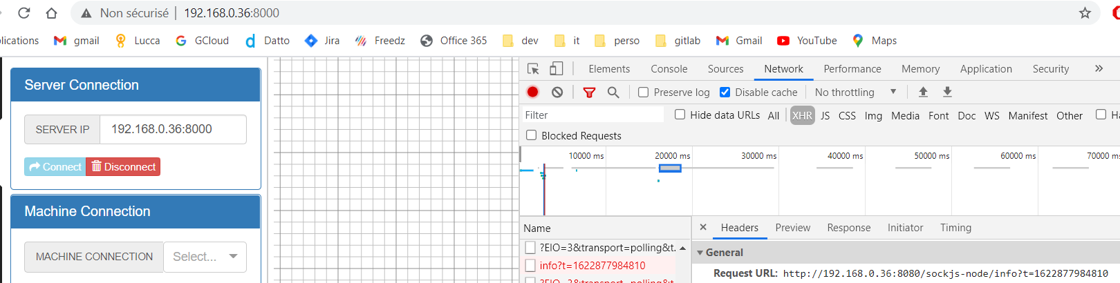

Did you set the server ip (and port 8000) in the frontend?
The default points to localhost, not the server.

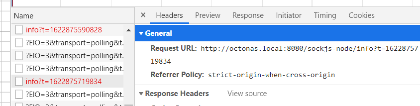

however, I did notice that the webapp is trying to open websocket on port 8080 that is not open in the image
I did change the Dockerfile and my dockercompose file to expose 8080 but that didn’t change anything (same screenshot).

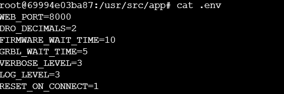

The ENV file must be named “.env” only, with nothing in front of the dot!
The websocket communication only uses port 8000 by defuault, but you can change the port by adding the following line to the env file:
WEB_PORT=8001 (whatever port you like)
here what I have
Where do I configure the websocket port (on the webapp side)? I havent done anything about this, this is default…
The server connection defines the ip and port for the websocket communication. The default port should be 8000!

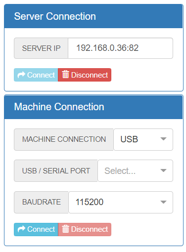

thing is 8000 is already taken by some other service… that is the reason I moved to 82
you can do that, aslong as you also reconfigure the server to listen on this port. So create a file named “.env” and add the line “WEB_PORT=82”.

I did get the 8000 port out of my way. so I can now use 8000 for laserweb but there is still this web socket to 8080 (!!!???)
