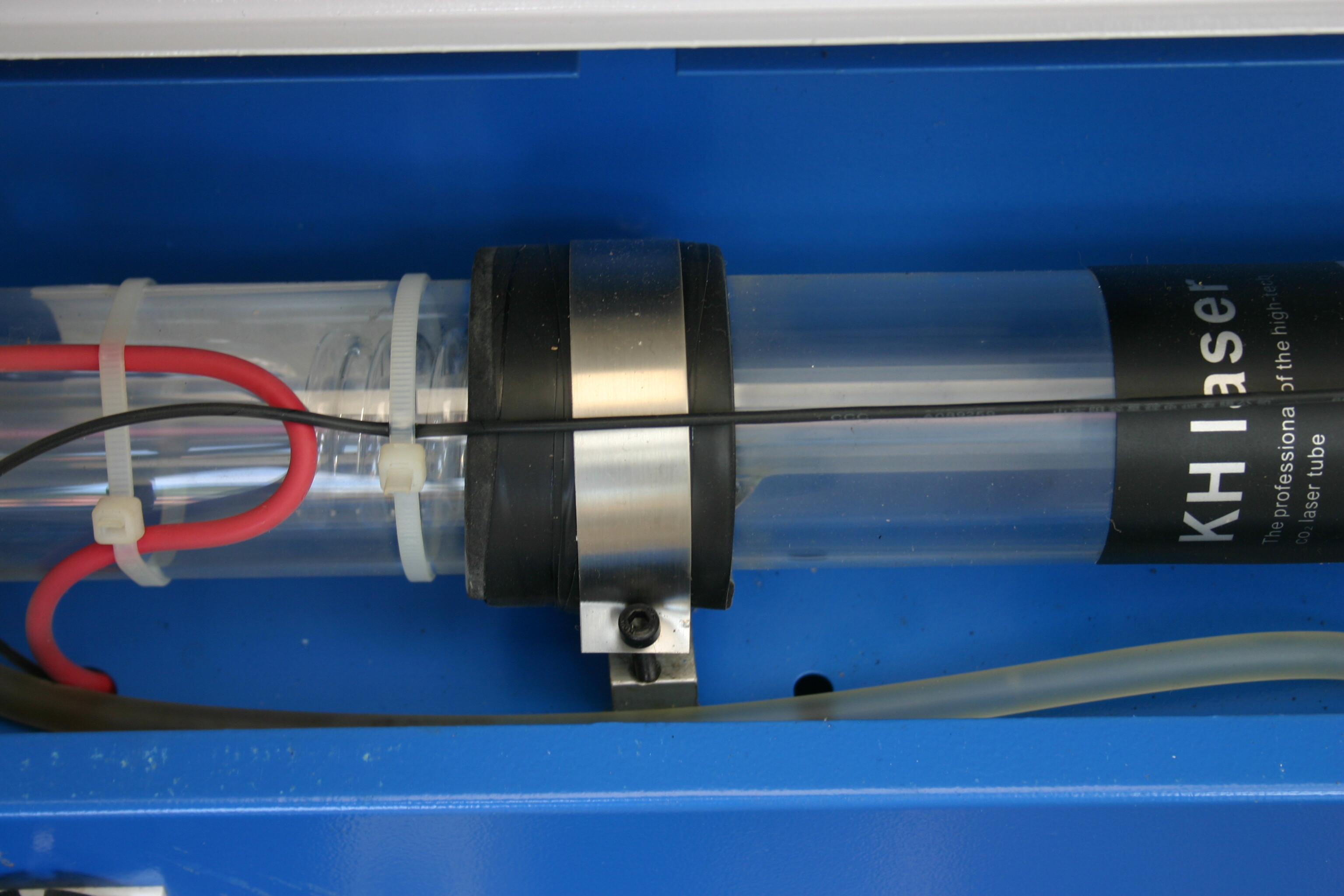

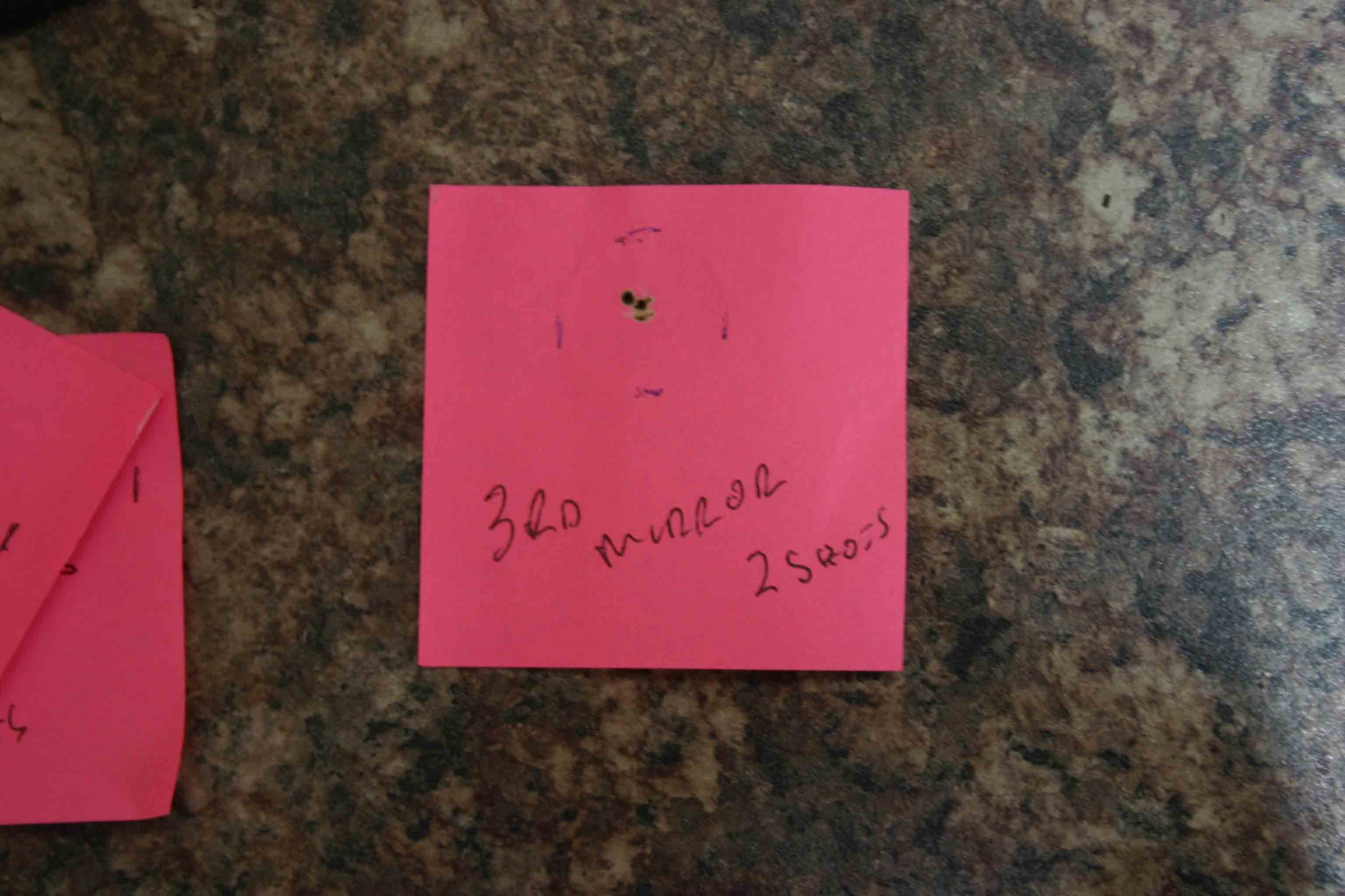

Post pictures of what a burn looks like at each mirror and also a video of the tube when firing.
i cant see what you are looking for
but here are the pictures of the tube
regards
phil
at the first mirror i get a elongated spot, because its at 45 deg
the 2nd and third good round dots
regqards
phil
hi here is the pictures of the burns they are out of line because i have been messing trying to improve it but they were lined up
regqards
phil
ps sorry for delay it kept bouncing it back saying files to large
