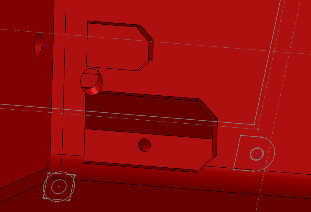

Here’s the exit hole… It’s too far away for even my longest hex wrenches, and it’s not in a good spot anyway:
So maybe it would make more sense to instead make the display panel screw in from the front side.
I gave up on trying to make the display panel screw in from the front; there was something going on with the display mounting boss sketch that I just didn’t understand, and it had something to do with the linkage to the display. I’ll just have to muck around with a hex wrench; it will work.

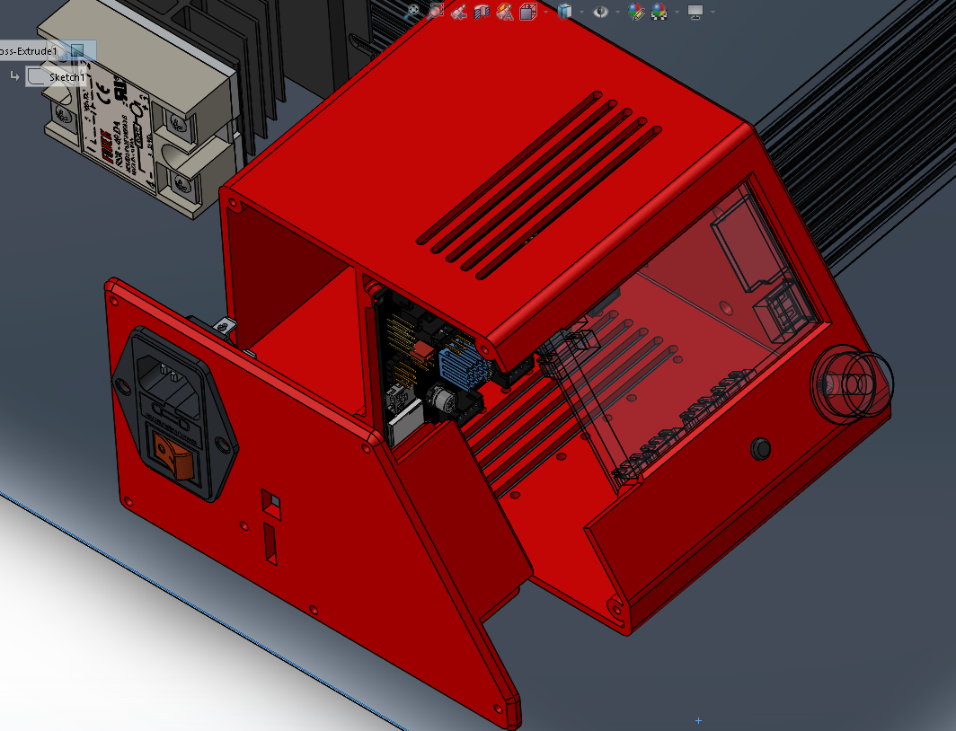

I also decided that I can use nuts to fasten the power switch mount instead of bosses. But I got side panel mount bosses filleted for printability, ventilation (passive slots, as well as ability to mount one or two fans against the bottom slots if necessary, and openings for USB and microSD in the side panel.
It could be more beautiful, but it’s progress!
I haven’t printed yet, but this is looking good!

I tried putting fans inside the case, which made it clear that if I add fans I should probably mount them underneath instead, which seems easier than trying to figure out what is best to change:
I really think passive cooling ought to be enough; having any fans at all is a workaround if it gets too hot.

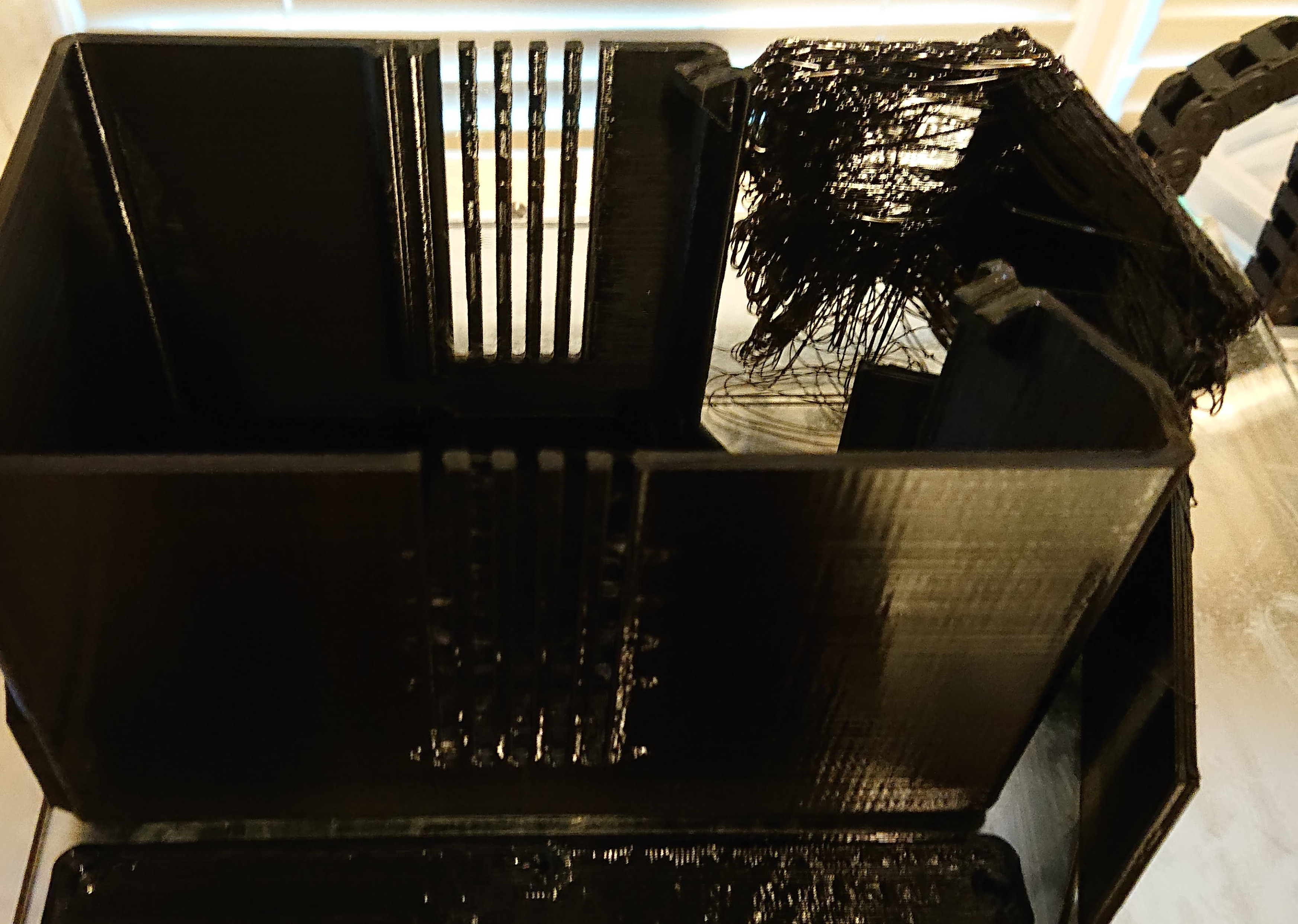

First failed bed adhesion I’ve had in a while. There are also some artifacts around the slots. So I’ll keep the black reset button that printed fine, flip the switch, and print in a different color later, slower, and probably one piece at a time so a print failure on one part doesn’t wreck other parts as it did here.
Also, the reset button was a snug fit in its hole because there was no clearance in the hole for it in the case, and it would have stuck down if pressed. I have now flipped the switch and added clearance around the reset button, and I plan to check all the hole sizes that showed up in the partially-complete print against hardware before I print again.
Flipping the switch took me a few tries to learn the best way in SolidWorks: I suppressed the one constraint that kept it from rotating it, dragged it around to rotate it, and unsuppressed that constraint, which now snapped it to the orientation I wanted.
This was a successful failure. I stopped the print early so it used less filament, yet I was able to get lots of measurements for what needs to change to make it successful. I think I had an example of everything I might need to change; we’ll see.
Not only did the tray detach while printing, but also the corners of the main box warped up slightly. I’m still getting used to PETG. @Eclsnowman can this be a result of the bed being too hot? I used the same settings that I’ve been using successfully for printing visors — 280⁰/75 first layer, 285⁰/70 subsequent layers — but those are only 5mm tall! :slight_smile: I’d appreciate the benefit of your experience here. I’m (still) printing on glass because my PEI bed has reportedly left China a week ago but hasn’t yet made an appearance in the US, which probably means stuck in customs.
My personal opinion is never changed the temperature of your heated bed during a print. All you’re going to do is inherently cause a contraction which is exactly what you don’t want to happen during a print.
It should be able to be held down with the right first layer settings and bed preparation, But if it’s lifting from the corners you could always add round “lillypads” at the corners for adhesion instead of a brim which are easy to remove. Another trick I use at certain times is to take a big flat base and put some relief cuts in the model, then when it tries to contract it isn’t such a monolithic structure and it’ll contract internally more than across its entire length.
Also if your bed is glass chances are the temperature isn’t reading accurately at the glass compared to where your thermistor is actually taking the temperature. So you might have to go slightly up in temperature for good adhesion. You just have to be a little careful with PETG because on glass it can grab so well that when it contracts it can actually rip out chunks of glass.

Yes, I’m using a glass bed, coated with a good layer of hairspray. I’ll raise the temperature to 80⁰C, let it stabilize for a while before printing, and leave it be while printing. I have definitely taken chunks out of glass with PETG, so I know about that tendency. Actually building the enclosure I’ve been intending to make would be a good next step!
The PETG might benefit from more consistent temperatures from the enclosure I haven’t yet built for my other printer.

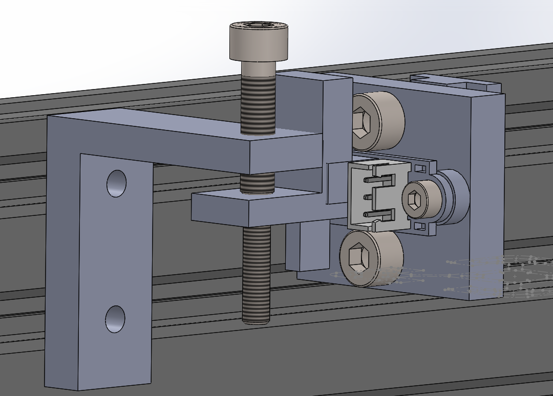

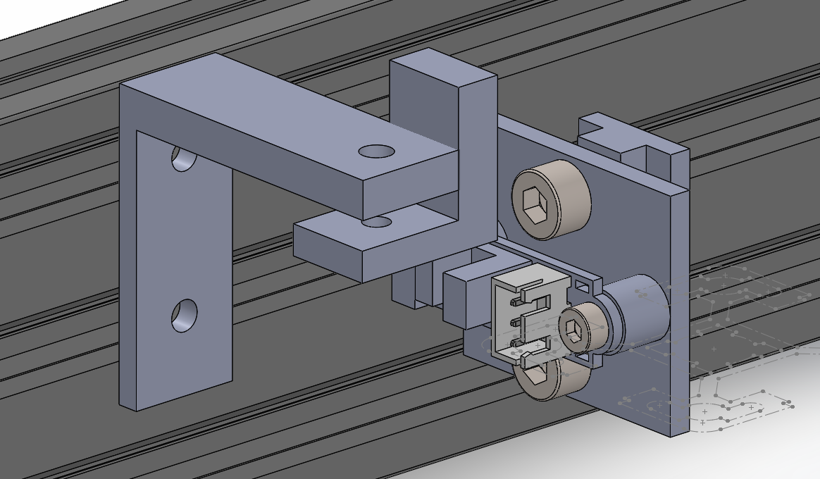

I didn’t feel like learning to model a differential screw (M5/M4) in solidworks, so you’ll have to imagine it going through the arm sticking out from the 2060, then through the flag that trips the interrupter. It looks like it could tear the endstop off, but actually I’ll set it up so that a hard stop prevents that. Each part is separately printable without supports.
I just have to decide whether to buy M4 and M5 dies or to single-point a dual-pitch screw on the lathe for extra street shop cred. :stuck_out_tongue: If I single point it, I’ll actually make both holes the same diameter (an appropriate minor diameter cutting 0.8 and 0.9 mm threads in whatever piece of brass rod I find in my shop probably), and then just cut different non-standard thread pitches, one in each end of the rod.
(Actually, cutting M5x0.8 and M5x0.9 would be possible with the standard cheap harbor freight set. I’d just need to put the follower on the lathe to cut a 5mm rod accurately first. Can’t tell whether they have it in stock at my local harbor freight though from their web site.)
I tried single-pointing 0.6mm and 0.7mm threads on separate sections of a ¼" (6.35mm) brass rod, but my threading insert chattered a bit since its angles weren’t meant for brass, and I didn’t cut a separate threading tool for brass. I also realized that it will probably actually be easier to have the threaded sections be different diameters; it will be easier to assemble. But my lathe follower fingers are too big for very small diameters. So I think Mark Rehorst’s technique of using an M5 screw and turning down part of it and threading M4 is probably the best technique, event when threading only through printed plastic where I can choose any combination of diameter and pitch that I want. So now I find out whether harbor freight has those dies in stock… They don’t; ordered a slightly more expensive similar set from Amazon in order to get it Monday.
(The reason I tried small thread pitches was there was no larger-pitch 0.1mm difference available without swapping out the change gears, which is a long and greasy process compared to moving knobs on the front of the gearbox… I do it when I have to, but I prefer not to if I can help it.)

I also had to work extra hard to convince solidworks to overlap a few screws to show what the differential screw will look like.
Can’t wait for my small metric die set to arrive so that I can make the hybrid screw and attach this for real!

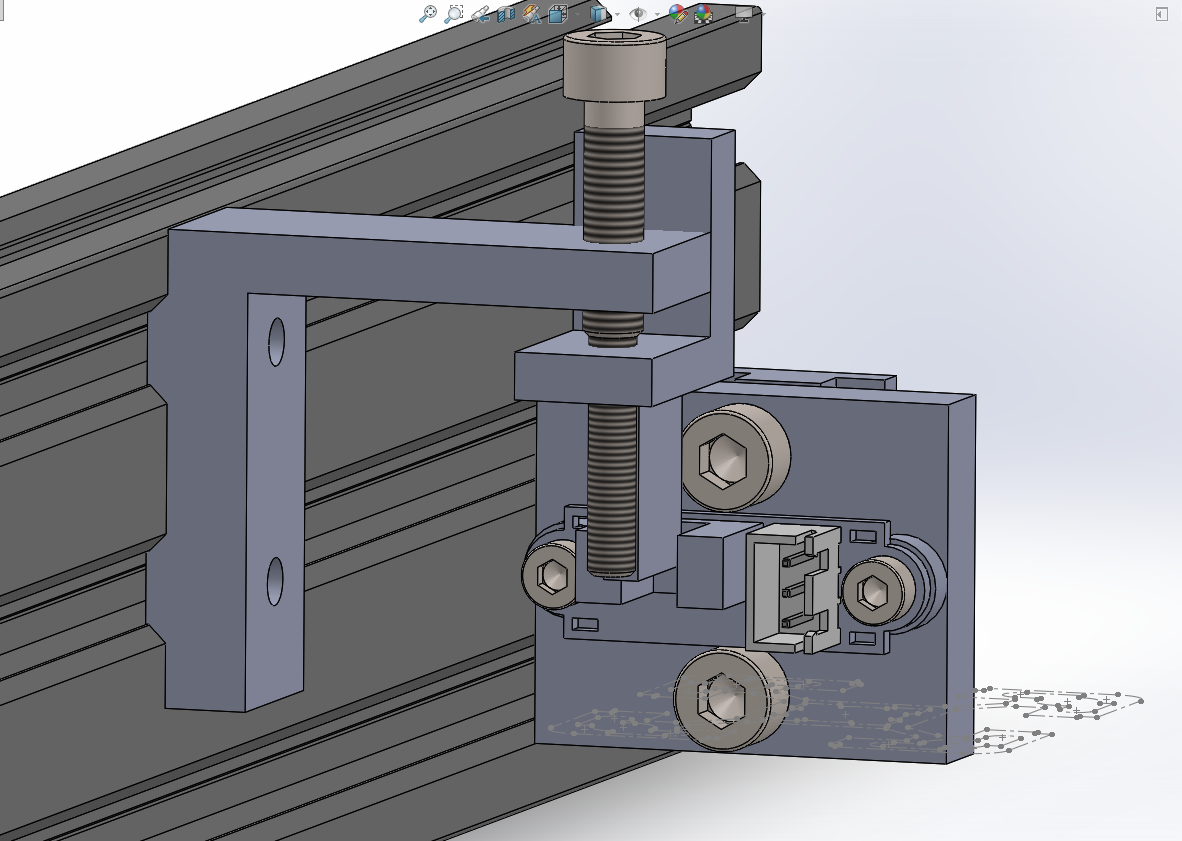

My flag is too small!
Also, it was a pain to get the flag mount arm aligned properly perpendicularly, so I added alignment features to attach it to the v-slot. I’ll see whether these work better. …Oh, yes, much better, much easier to align!

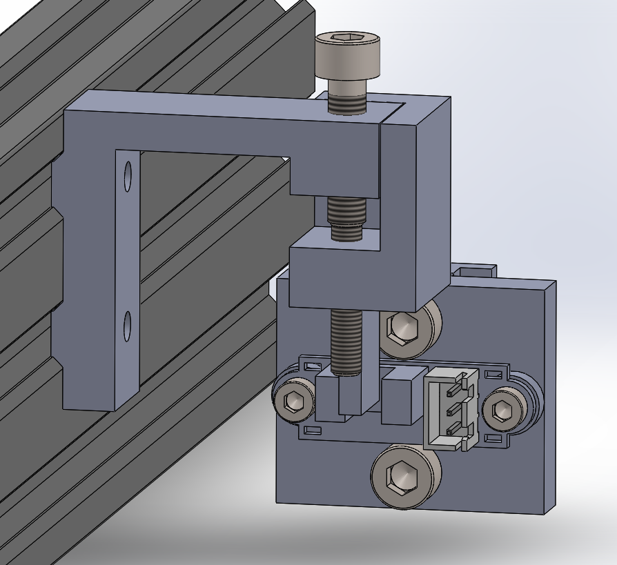

Made my hybrid screw. Discovered that I need substantially longer holes for the screw to go through, as it just wasn’t straight enough. I’m also going to tap holes in the mill to make sure I’m tapping straight, instead of just quick doing it by hand.
Also discovered that I was adding negative clearance between the arm and the flag, which didn’t help it stay straight. Added a second side while I was at it and fixed clearance. Should print and test this tomorrow!
