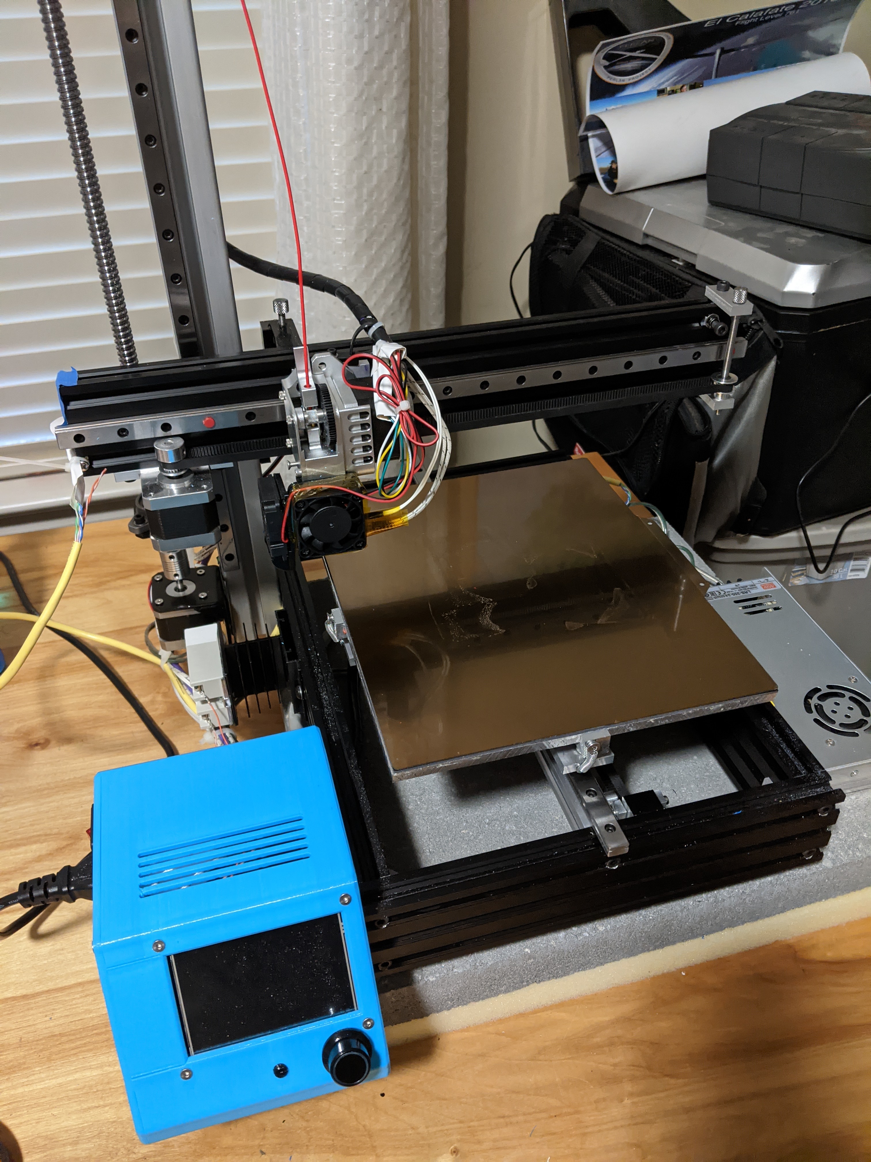

Cantilever printer design based on leftovers

The cantilever arm does rattle a bit, and inertia from the bed moving back and forth does rattle the cantilever arm, which does affect print quality. The linear rail I used wasn’t very high quality. I’m trying to decide what the next step should be. I think my options are:

Yeah, you are using some heavier components than most cantilevered setups use (direct drive, heavy duty bed). I think gusseting, adding a second tower or lowering acceleration is probably in order.
Do you have pictures of the current configuration?
There is very little play; I can feel it but not obviously see it, and I haven’t tried to measure it with an indicator.
I don’t think the direct drive is a substantial contributor; it’s only contributing inertia in a strong direction (up and down) with very little deflection opportunity. I think the bed shaking back and forth is probably the main source of the arm shaking back and forth. I have some 2040 and all necessary hardware sitting around so it’s an easy test to do. It was always an option, and in fact the first design wasn’t even cantilever at all.
It does have fairly low Y acceleration already, which I did precisely because of the mass of the bed moving back and forth.

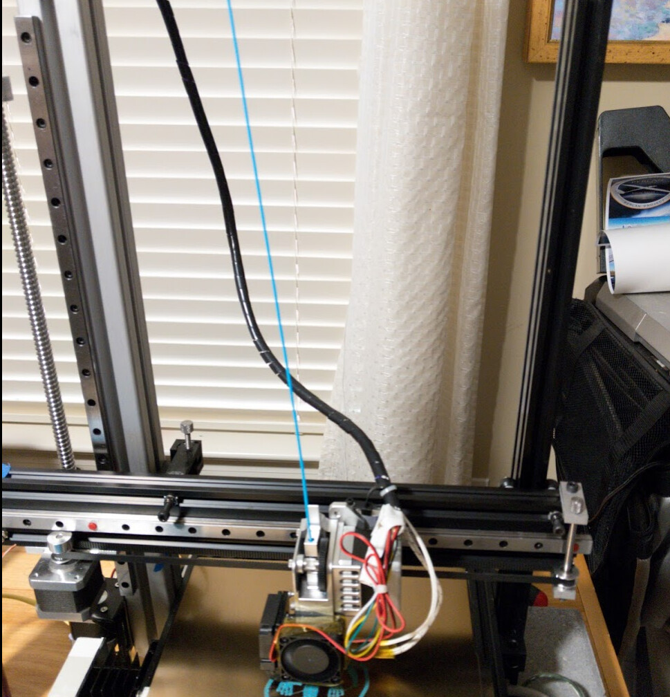

I had to do a few hacks. I used mini openbuilds wheels and a mini gantry plate. Then I realized that all the holes in it other than the axles holes were tapped M5, so I had to drill them out to 5mm. And the normal ¼" spacers weren’t enough to clear even button head screws, so I had to add 3mm spacers and switch the M5 axle screws from 25mm to 30mm. Then because the screw heads are inside the wheel axles they can’t be adjusted with the stabilizing tower installed, so it was trial and error until I got the plate screwed to the right place in the arm.
So it no longer looks like a cantilever printer, but it should work better.
Looks weird…
Here’s how the tower is attached:
Showing the extra 3mm shims to accommodate the screw heads
This is clearly a make-do hack and moves this way beyond what makes sense for someone else to reproduce.
