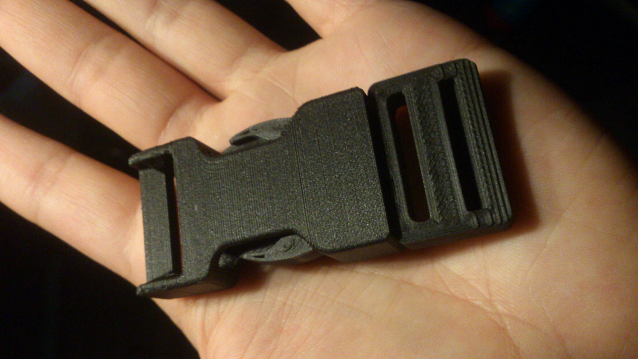

Carbon fiber filled XT arrived yesterday.
Carbon fiber filled XT arrived yesterday. It’s not often that I drive into work on Saturday to play 3D printing, but I did today. I’ll do more of a write up later, but basically: IT’S AWESOME.
Prints very easily, easier even than standard XT. The prints are the stiffest I have ever made. The output is not too brittle despite being stiff. The tough, flexible amphora as matrix polymer really shines here giving really nice layer adhesion, overhangs, bridges etc. Support material and raft removal is superior to unfilled XT.
The prints look gorgeous, graphite grey with a twinkle of lustre from the carbon. The filament is incredibly consistent as you would expect from colorfabb. I was able to print through a 0.25mm nozzle with no drama, but did most of my testing on 0.40mm.
I used standard brass nozzles, even though I have some stainless ones, I want to study The wear rate of carbon on our brass nozzles. I’ll report back when I have data on that.

wonderful, you modeled this clip? How is carbon fiber’s flexicity?
Thanks for sharing!
@Alex_Cam It’s this buckle:
http://www.thingiverse.com/thing:348729
XT-CF20 is very very stiff, but the buckle is fully functional and the fingers flex nicely. The snap as the barbs pop into place is very strong.
