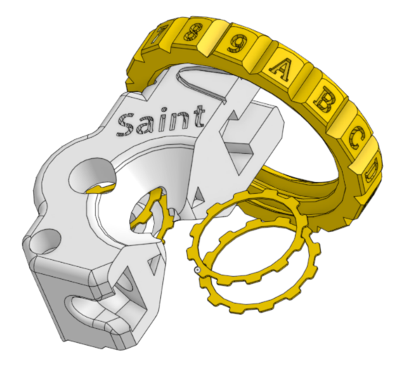

"Casino chip" design on bearings to help seeing filament progress and retraction on (Sorry
“Casino chip” design on bearings to help seeing filament progress and retraction on #saintflint (Sorry for the poor light condition). Soon available at the nearest 3D printer near you. Stupid simple and a bit more good looking than the nail varnish from my daughter (don’t tell her). Before you ask, yes that’s an Onshape logo I am printing. Fooling around for Lisbon Maker Faire 2015. :slight_smile:
#makerfairelisbon
#saintflint #onshape

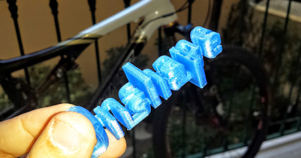

Didn’t come out too bad for a first attempt
@Alex_Skoruppa Slightly improving airflow efficiency in theory (not sure if it does). Like the look anyway…
@shauki Yes sir. Trying to win the Model Of The Week contest on Onshape
Easy… Extrude, Copy and Rotate 90 and Boolean Intersect. You just have to do some manual work where material can miss sometimes.
