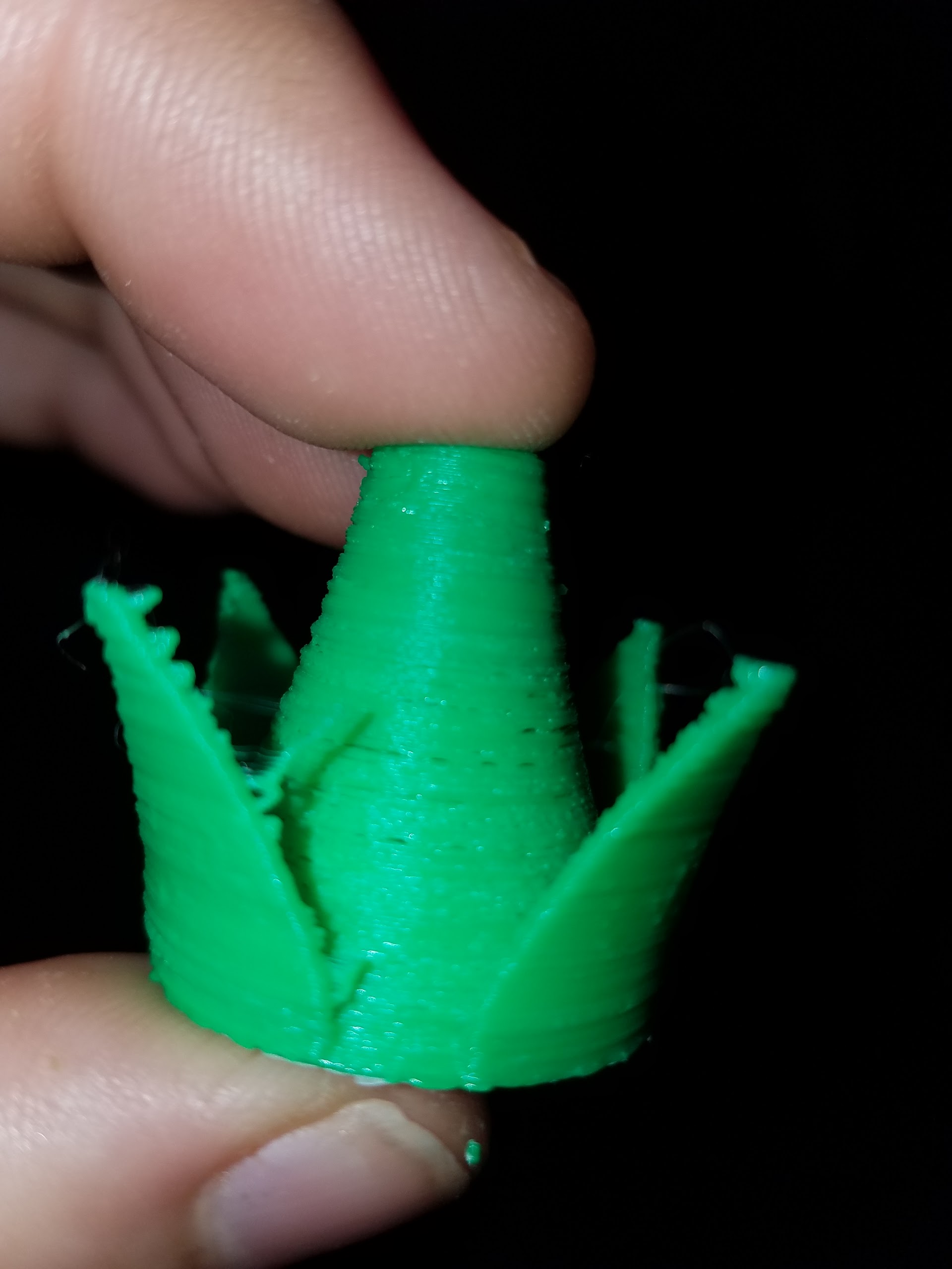

Changed layer height to .2.
Changed layer height to .2. Is extruder to hot now (255°C)?
It seems over extrusion, what material are you using?
Over extrusion was one of the settings adjusted. Between that and some temperature adjustments, I was able to clean the prints up. This is Hatchbox’s Green ABS pictured here, and thanks for the help.
