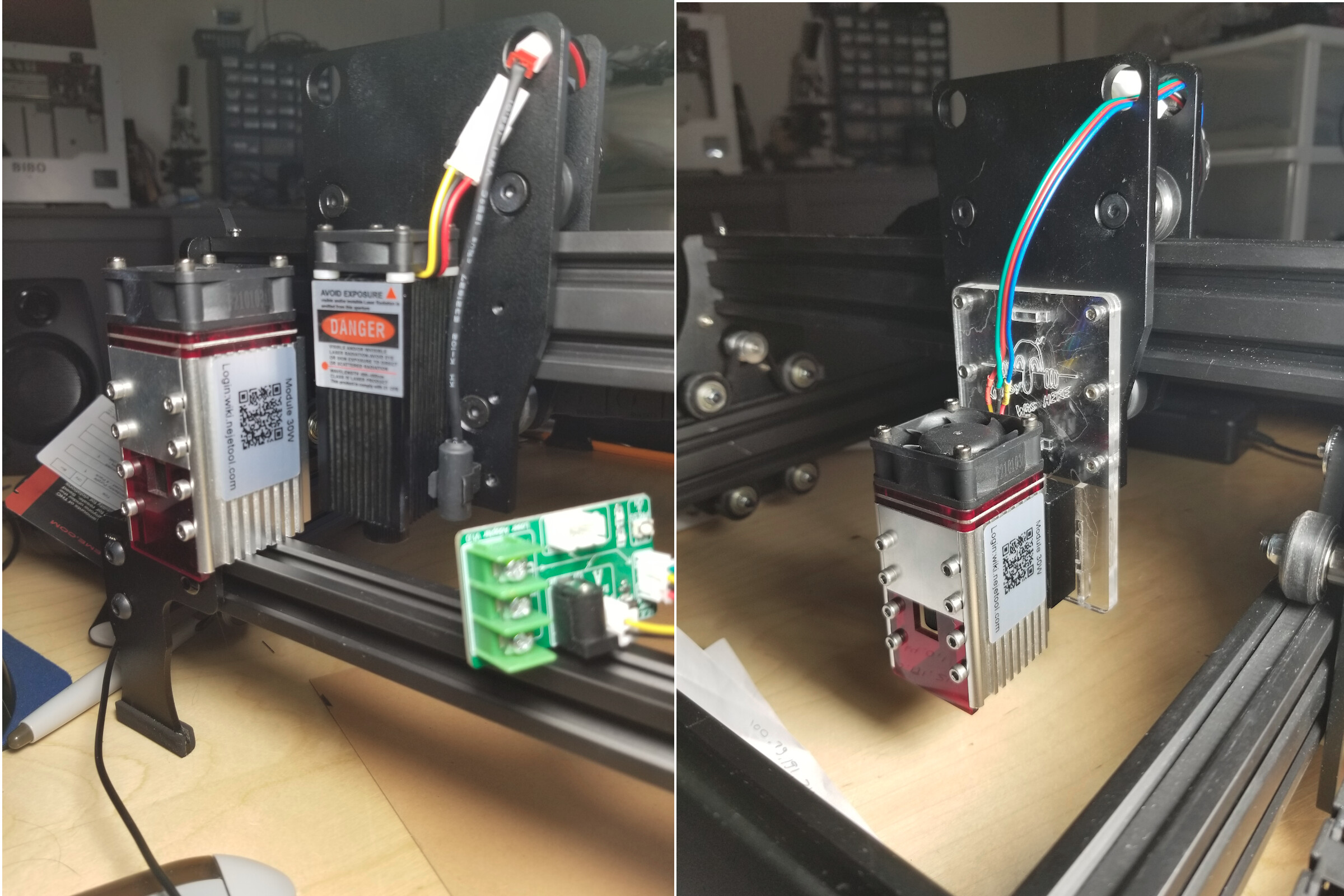

I upgraded it to the Neje N40630 module.
This is the original compared to it’s replacement and the current mounting.
Let me know when you get yours… :slight_smile:
