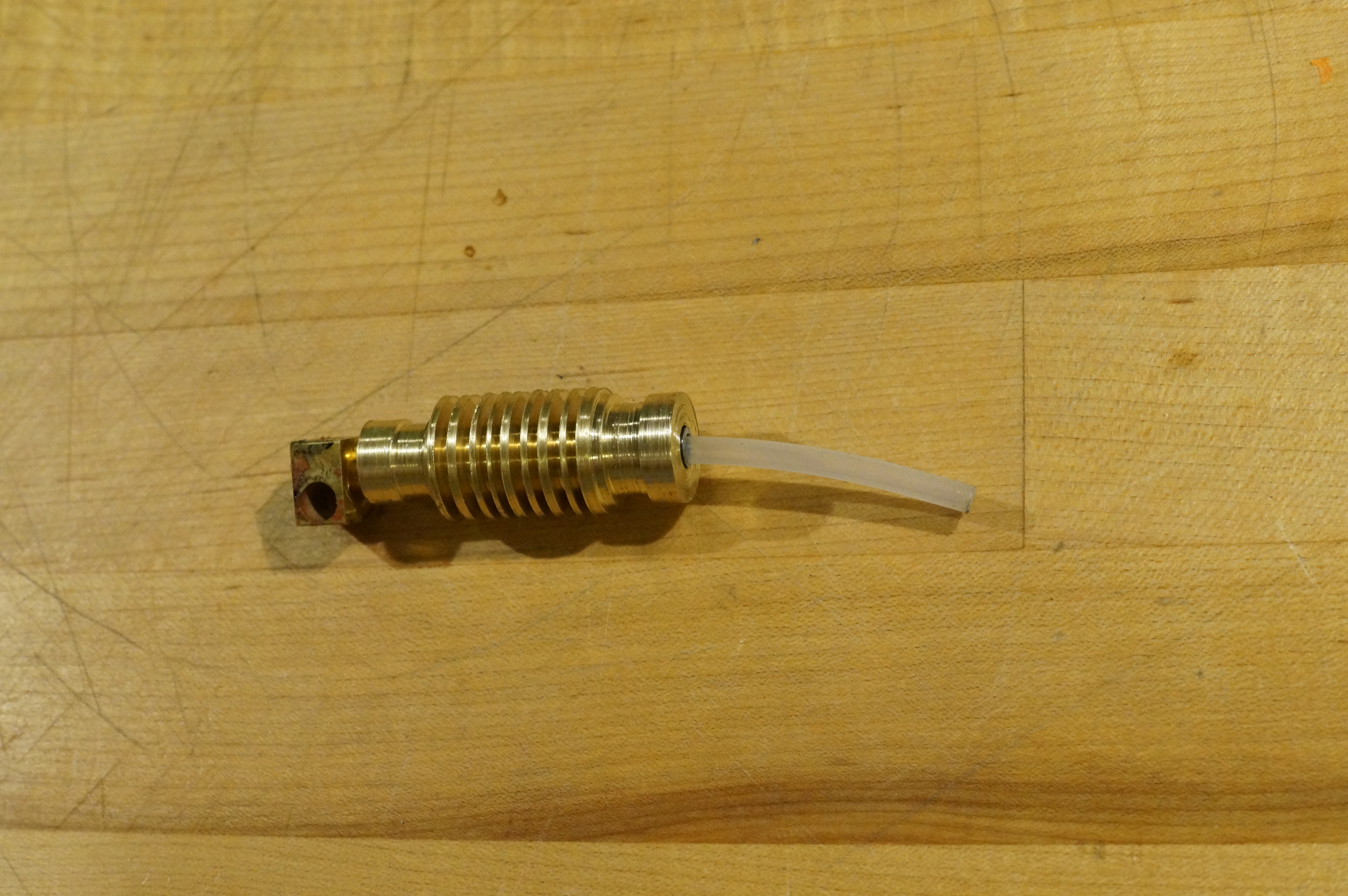

After a night’s sleep and a day where I couldn’t get into the garage (and the feedback from the group). I now know that a good extruder gets hot in some places, but stays cold in others.
Over the years, I’ve found if a part exists, it’s always cheaper to buy it…where a lathe comes in handy is when that part doesn’t exist, it’ll make it exist.
So I turned a steel sleeve that would fit the ID of the cooling tower and the OD of the PTFE. I’ll mount things up and see how well things stay hot and cold.
Read @nop_head 's ‘the story so far’ collected blogs if you really want to understand why ‘hotends’ are the way they are. Your time on this is a whole lot shorter because of those before you. It comes down to the dynamics of what happens to the filament from solid to liquid ! Press on !
Yup, this has turned out to be an interesting tangent. Got it all wired in and…well…brass is a GREAT conductor of heat. :smiley:
Poor little resistor couldn’t raise the environment above 150C…the top of the the assembly reached about 102C, and with the fan blowing on it, the temp at the hot end droopped to 130 or so.
Good thing all it cost me was time.

Still not convinced on stainless steel. Our Ubis hotends use peek / brass and are bulletproof if the thermistor does its job :wink: exotic filament is pushing us forward, our next experiment may be ceramic as the insulator. Manufacturability is our chief concern at this point. We make 1200 a month. Price is our next concern. I still think our $59 fully assembled Ubis hotend is a hard value to beat. How long it takes to build something is a huge part of the equation.
It’s an interesting math experiment. Building a part like this, especially in volume, is a balance between a lot of things…PEEK has it’s benefits, but the required additional components (PTFE), unit cost (it’s roughly three times SS’s cost) and machining, make all-comers pretty equivalent in cost.
The other thing to consider from an all metal hot-end is: lets just say the same thing happened there: the thermistor pops out, the heater shoots for the moon…how long does it take for the e3d to melt the printed base it’s sitting in? (Often it’s a case of finding the next weakest link down the line.)
