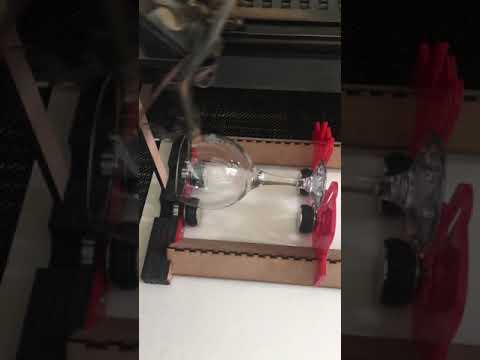

Cheapest Rotary In The World!
Not my idea, but it makes sense.
Ideal if you’re not planning on doing lots of etching :
Hmmm… interesting. Exactly how is turning? Is it somehow using motion of the x-axis to drive the rotation?
Yes… its being pushed by the Y axis.
Ahhh…I see now. :slight_smile:
This has an added bonus of not needing to adjust the y-axis scale. If it has a tall stick on the right side also it would even self align (more or less)
It does appear to have a stick each side.
You could also ramp the bed slightly, to stop the Y axis “bumping” it forward (gravity assist if you will).
