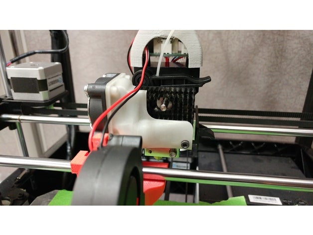

Just over 2" of span with hardly any sag. Using this high efficiency part cooling fan:
Rigidbot single head cooling fan mount Rev-2 by JP1 - Thingiverse
This setup is testing a new PLA filament from Vortex 3Dp (retraction settings still need to be adjusted) on a modified RB3 from ReliaBuild 3D with a side mounted extruder cooling fan that can be found here:
The part cooling fan helps keep the ooze to a minimum but also cools the little branches that did appear to the point that they don’t stick hard and just brush off the finished print.

The part cooling setup is 99% of the key here. I love what this part cooling fan allows me to do with my prints.
The part cooling fan has a high static pressure and no turns or obstructions in the duct so the full pressure drop takes place at the exit in a very focused path crossing right at the tip of the nozzle. No temp fluctuations of the hot end.
I bridge at full print speed and layers of 0.1mm (thin layers have less mass to cool and less weight to cause sag) with the fan cooling at 100%. It cools very quickly.
