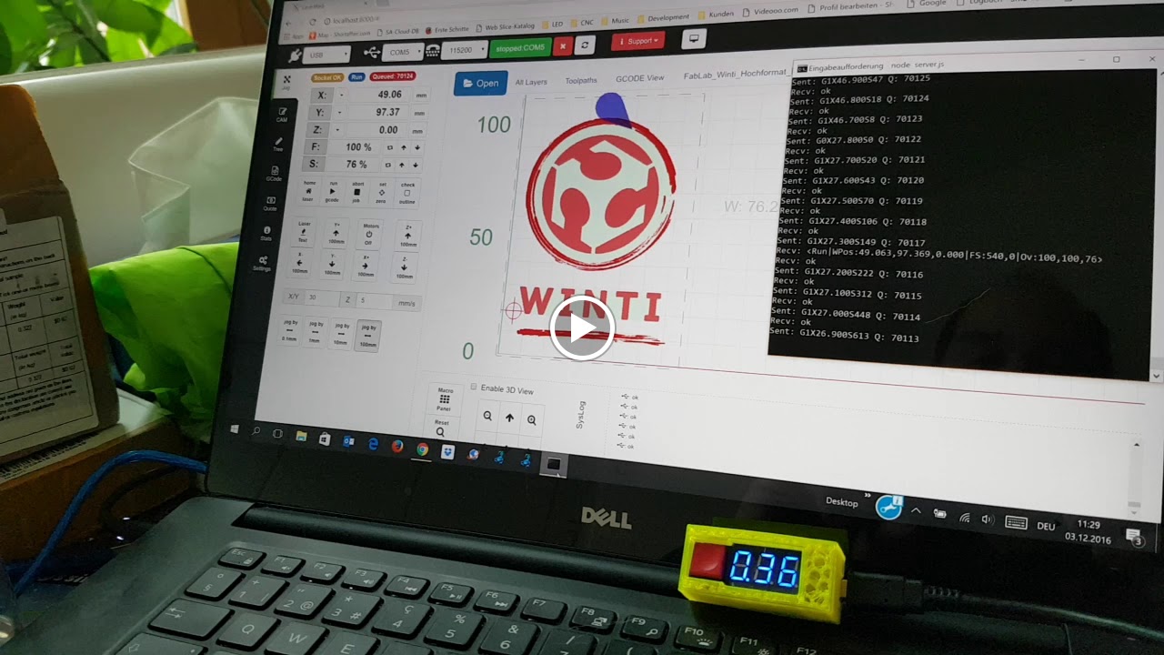

Checkout my GRBLsim! It’s a tiny Arduino Nano with a voltage meter showing laser pwm. Very usefull for mobile development.
Can you share the source files for this? I would love to have this as an additional LaserWeb testing tool.
@funinthefalls Do you mean the softwar or the hardware?
Software is standard Grbl 1.1d (beta).
Hardware is a Arduino Nano (without headers), a mini Voltmeter connected to pin D11 (spindle pwm out) and a button connected to pin A2 (cycle start/resume) to ground.
You can also just use a nacked Nano, if you don’t need the display and button.
The 3d-printed part is just a quick hack yet, that needs some work still.
