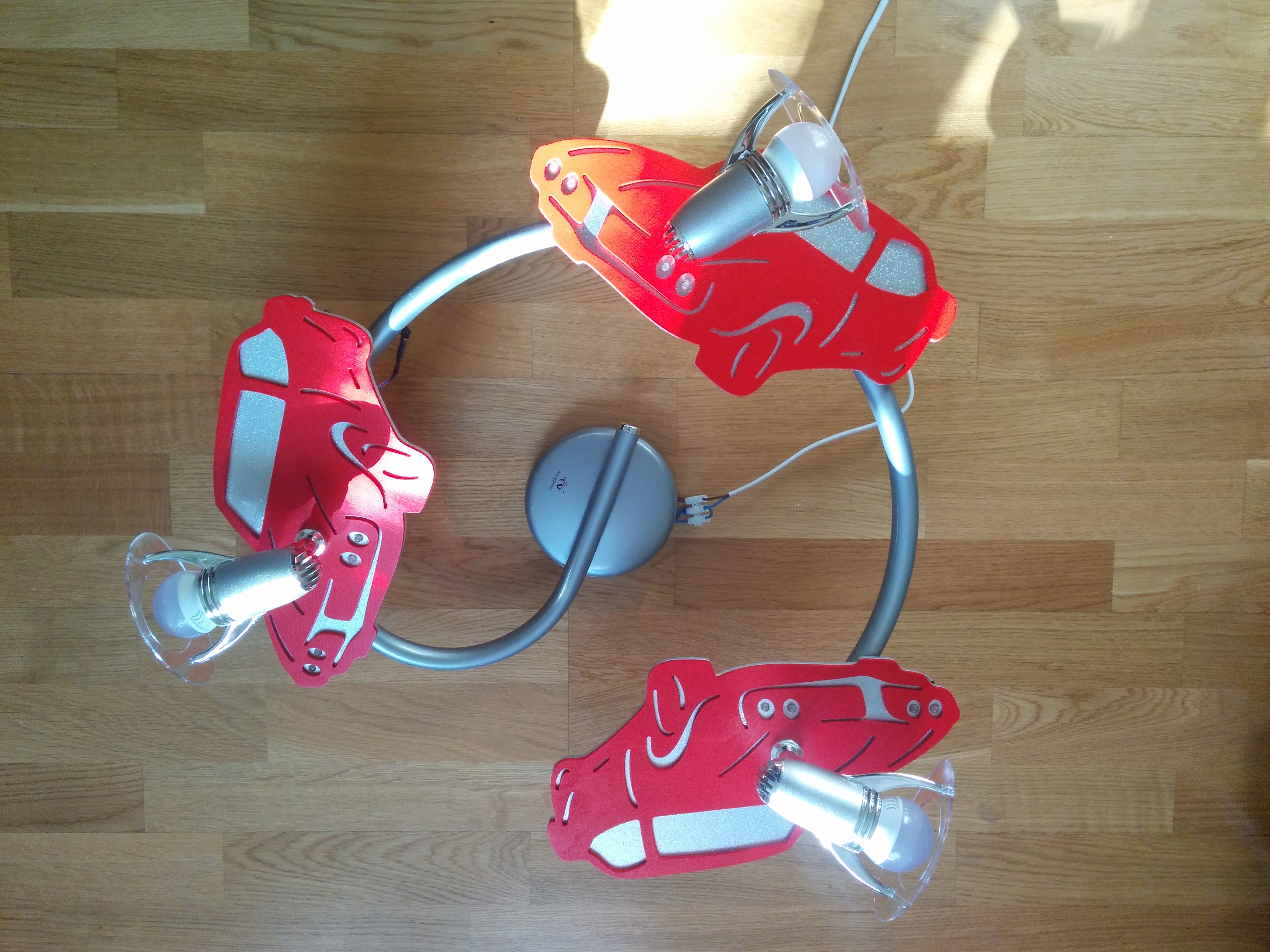

Children room lamp with remote control. Mini Pro + 12 x + relay card.
arduino Mini Pro + 12 x #WS2812 + relay card.
Code: GitHub - artur3/Lamp: Lamp for children room, Arduino Mini Pro, 12 x WS2812 (FastLED), IR remote control (IRLremote), relay card

@marmil Do you mean IR receiver? I’m using IRLremote and everything seems to be working OK. LEDs sometimes blink or randomly changes colour but I think this is not related to IR libs (adding 1000uF cap helped a lot).
