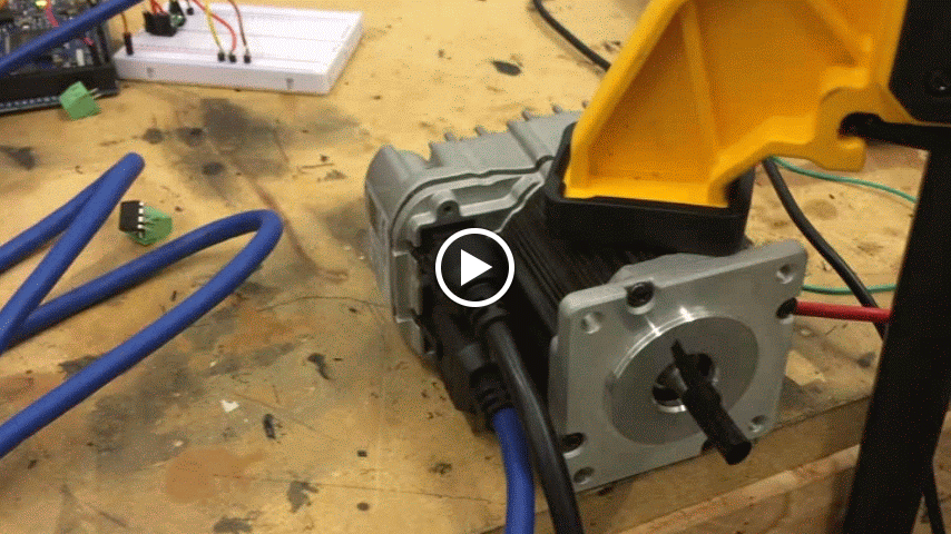

@ChiliPeppr and tinyg2 driving my clearpath servos. These things are powerful and oh so silent. An arduino due and a $2 level shifter later we have cnc control via usb. So much better than hunting down and/or building something with a parallel port. Excited to get them installed on the machine.

@Frank_Graffagnino making progress! https://www.youtube.com/watch?v=fpkMKdzCIJc
What are you using to power them?
@Gato1 teknics makes a power supply that is 75v that these servos plug nicely into. That is what I have powering it, I will try and get a shot of it in my next video.
