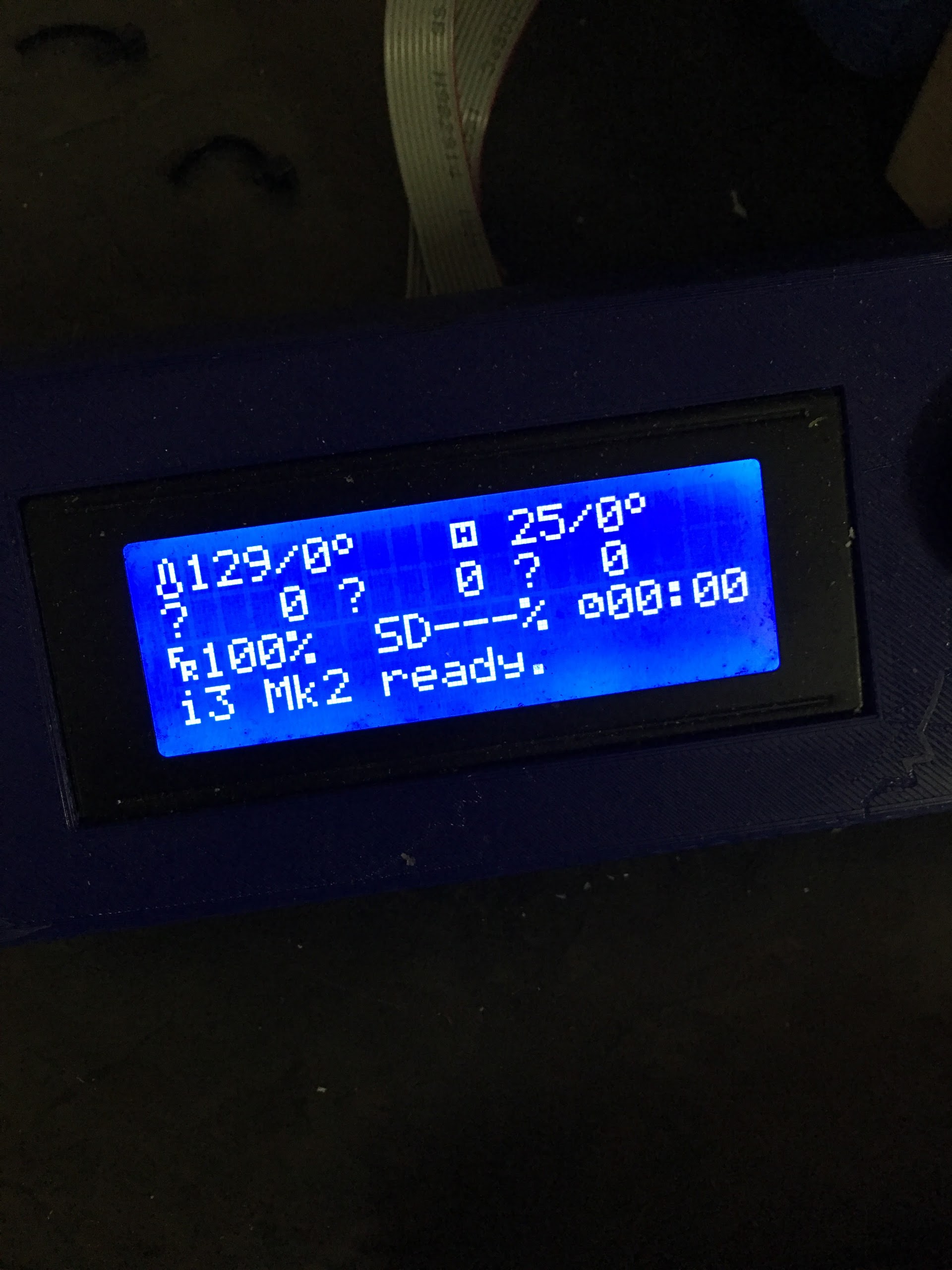

Chinese e3d thermistor, any idea which one to pic in marlin.
Chinese e3d thermistor, any idea which one to pic in marlin. Either I’ve moved to mercury or this ones wrong.
Dang man go buy an A/C unit!
But seriously, the cheapo e3D’s don’t seem consistent to me. Any way you could ask the vendor?
Try thermistor 1, and thermisor 5.
Normally it’s one of those
Replaced it with another one seems it was faulty.
Chinese thermistors can be very hit or miss. I had two supposedly identical thermistors embedded into the same bed heater that were very different in beta and To numbers from each other and the spec that it was embarrassing.
