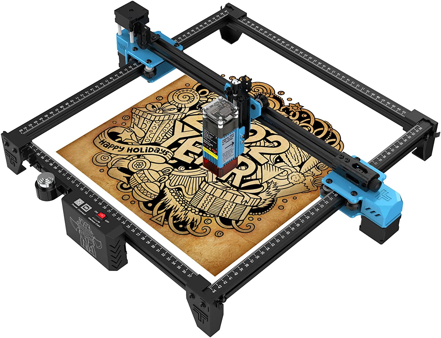

I’m ready to buy my first laser cutter. As a Linux user, I have noticed that most laser cutters are designed to work with commercial software. Because I have not yet bought my laser cutter, I’d like to know if there are any models that are known to work well with LaserWeb4.
I’m currently considering the purchase of the following one, on Amazon:
Would this one be okay? Otherwise, I’d love to hear from those of you who own a laser cutter, and have found that it works well with LaserWeb4. Which model do you own, and which ones do you recommend?
Thanks, so much, for taking the time to read my post. I look forward to hearing from anyone who feels they may be able to offer suggestions or guidance.
If it’s running GRBL v1.1f or later you should be good to go with most any software.
Thanks, so much. That’s a huge help!
