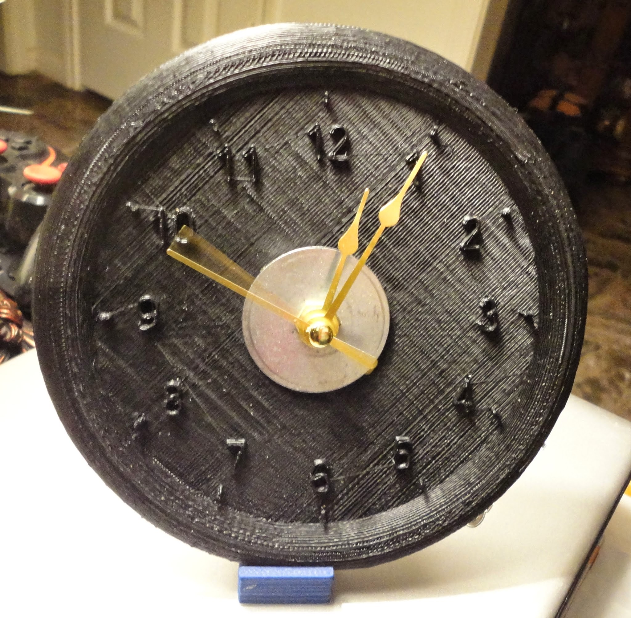

Chris Mitchell  Here's an example of almost bed filling print I did a few
@Zane_Mitchell Here’s an example of almost bed filling print I did a few days ago. ABS on Al bed with Kapton and Aqua Net. Hard to get up, but absolutely no curl at 90C on the bed.
I haven’t released the OpenSCAD for this yet (but will soon) but it is also part of my second OpenSCAD book which will be out “soon” :wink: Will look better with the numbers painted and probably black wasn’t my best color choice.
How big is it.
@Wayne_Friedt The face is 120mm across. The ring around it adds about 10mm on the XY axes so about 130mm. In theory, I have a print area of 200mm but with stops and other limitations about 180 is the top end before I have to start being careful.
