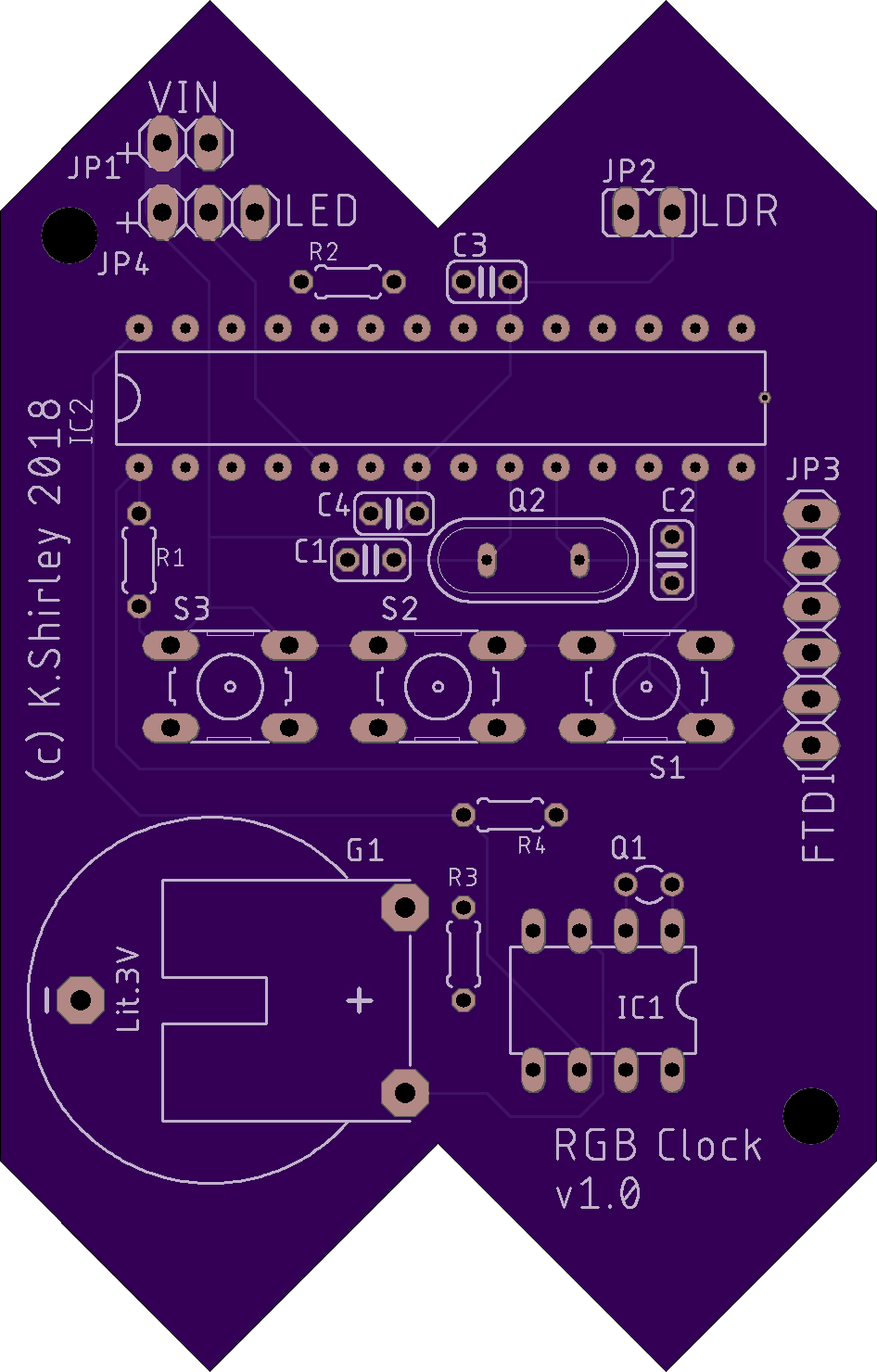

Circuit designed for my RGB Clock and PCB ordered from OSH Park, can’t wait to get them in my grubby mitts :smiley: I have also been updating the github wiki to explain all the modes that the clock can do along with how to build it.
I have updated the github with the circuit and PCB design (used Eagle).
I would really appreciate if anyone would be willing to look at it and let me know if it makes sense! https://github.com/smartroad/RGB-Clock/wiki

Nice layout. I assume the bottom layer is the ground plane?
@Stephen_Co Thanks. Yes the bottom is the ground plane :slight_smile: Made a slight booboo with the ATMEGA, the holes are too small lol so I’ll bodge it together this time then refresh the layout to correct the issue
