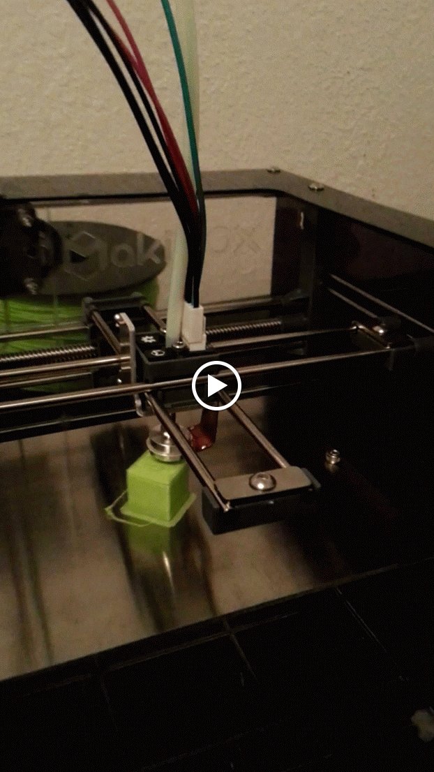

Cleaned the feed tube ,
Cleaned the feed tube , shaves a little off the hole.for the zendrive wheel and im back to printing. Im scared tho the hot end is making this crazy poping noises during the prints. Whats the deal @Makible , any clues for me? Dosnt seem to affect the print but sure is scary. #makible #makibox #scaredasbleep
Could be moisture in the filament popping. Can you see any tinny exploded holes in the prints?
Now that you mention it there are very very tiny bubbles and it’s only oops when it is extruding
PLA? quite possibly damp filiment.
Abs
You could dry it out in the oven. 60C for 1/2 hr or so

As others have said, you probably have damp filament and the popping is the water ‘boiling’ as you extrude. A short bake in the oven might help, did the filament come with desiccant? ABS can make popping sounds too, the temp might be too high. Can you get some good high res shots of the object and the fill pattern? That would help.
Kenneth for my personal experience, try to slice same cube or other item reducing HE temperature of 1 or 2 point
From my experience, that’s indeed because the filament has absorbed too much moisture.
I had the same thing happen to me, after I let the filament sit out in the open for a few weeks.
After the first few layers from the “moist” spool, it stopped popping again.
