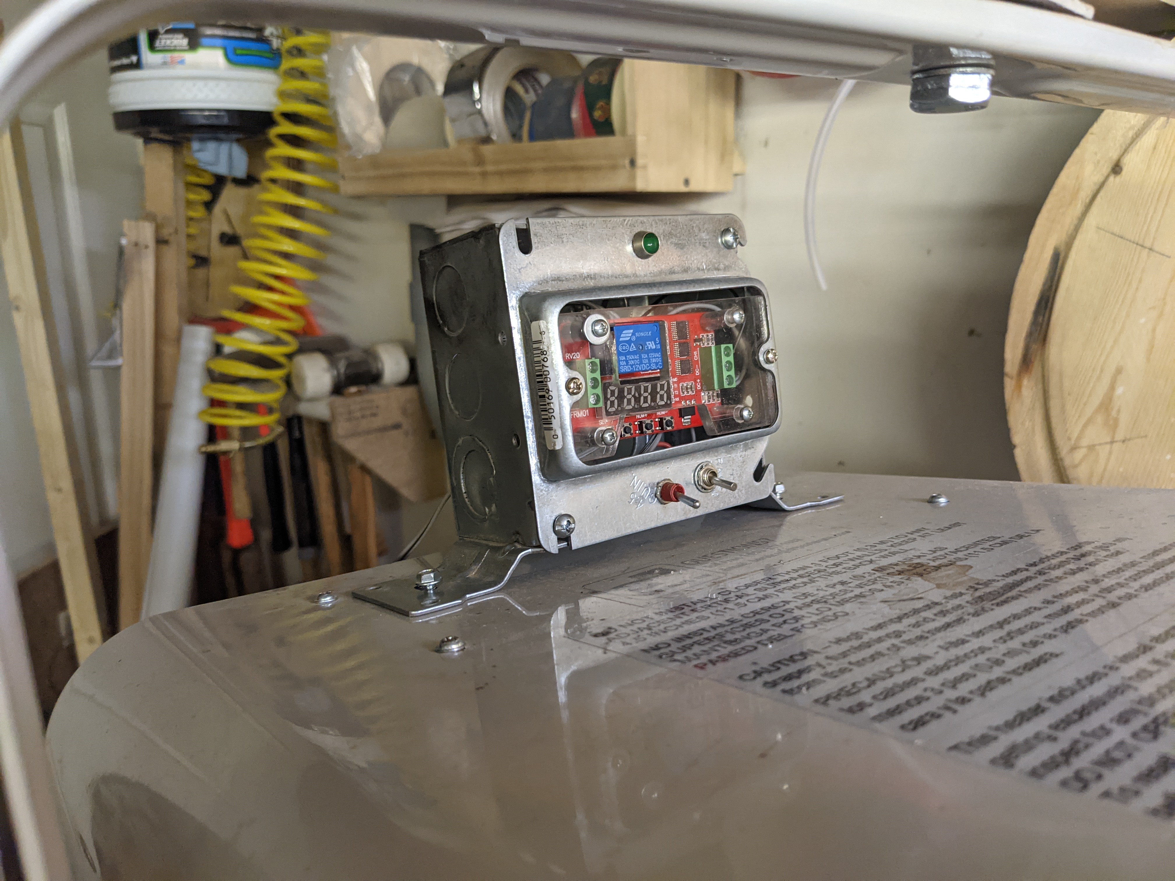

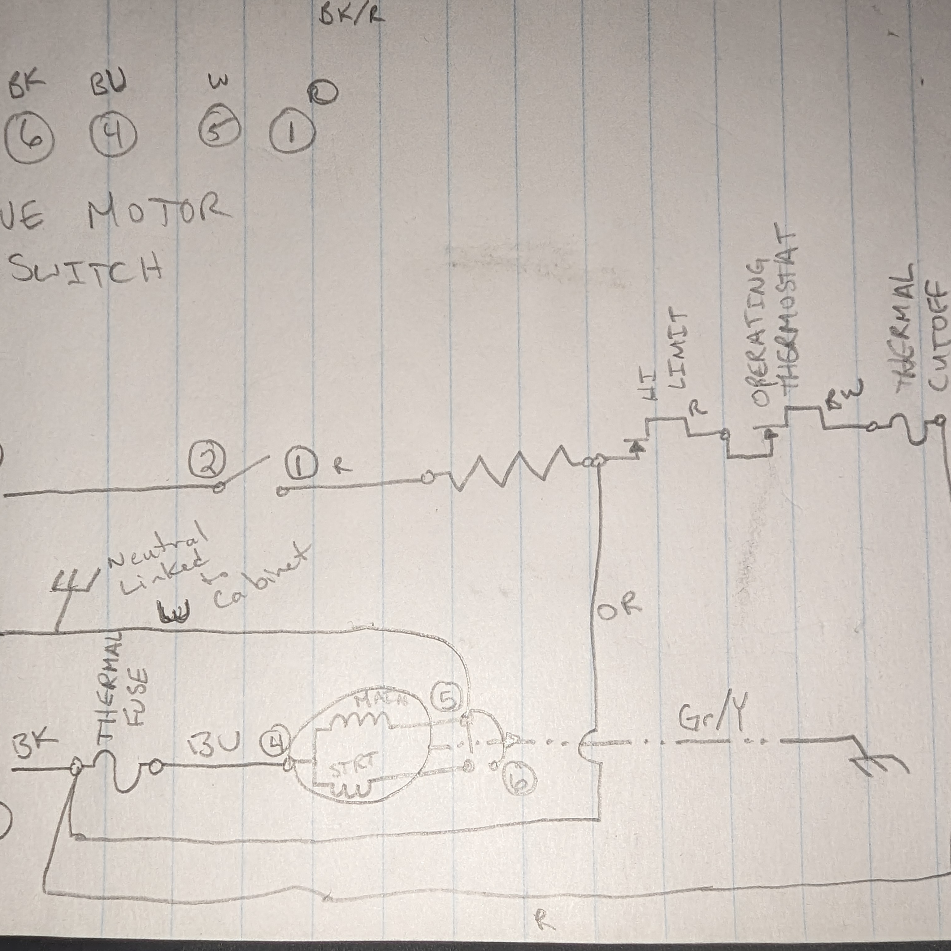

Ok so after studying the heck out of this thing and how it operated I believe I have it rewired eliminating the timer controls and running it off of a line volt thermostat without adding any other electronics. I’ve drawn up a diagram that I hope makes sense if anyone wants to make sure I’m not going to set myself on fire.

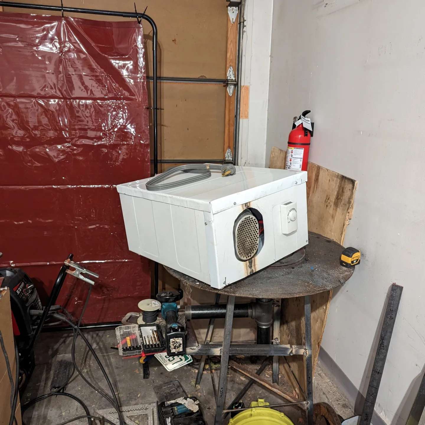

still gonna throw a filter box on the back so i can reduce wood dust getting into the element, but she is all done.
Wow, that does not look anything like a clothes dryer. :+1: :+1:
Looks like a nice build.
The forum could benefit from some details on how you built and wired it?
That’s great and very nice repackaging work!
Yea, I will try and draw up the wire diagram a bit better and take the top off to take some pictures. I’ll be honest I have not test run it since I completed it only because I don’t want to test it in my laundry room lol. So until I can put an outlet in the garage to test it as far as I know, it works as intended. I did do a test run after I completed modifying the wiring before I started to reshape the box and it did operate as intended for the few seconds I let it run, but have not done a real test run yet. Still, can’t wait to run this and see how it performs.
