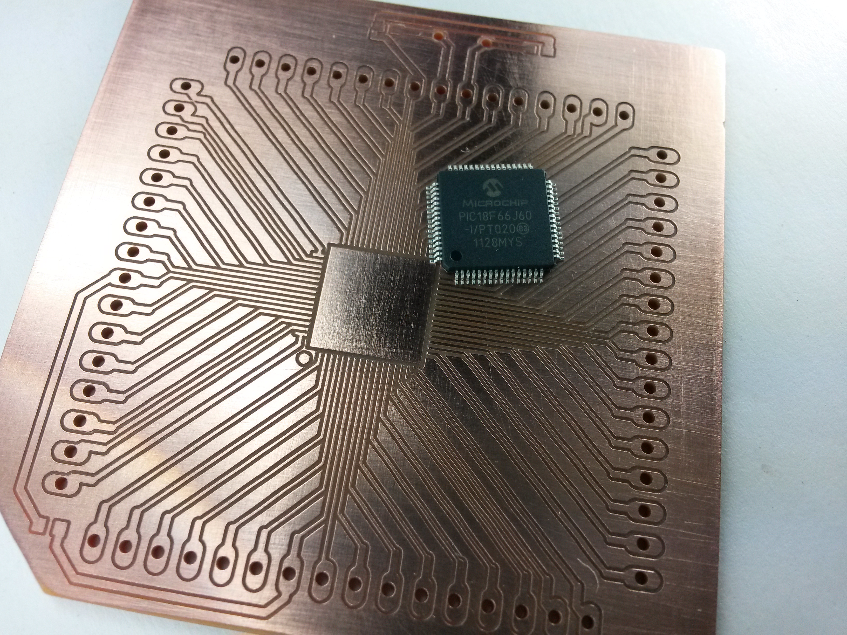

Cnc homemade, v-bit 30° 0.1mm
That’s pretty, but I still prefer chemical etching…
I think you’d be hard pressed to get something that clean and fine pitched with chemical etching.
The way I use to do it:
Always planned on using the vinyl cutter to cut a mask for etching, but this looks promising. Could use the CNC to drill the holes n do a double sided board…

I prefer a mill. Holes perfect and perfectly aligned, no over-etched bits, double-sided trivial. I built three different boards on my mill today, and cleanup consisted of a minute with the shopvac. Then again, part of that is I haven’t ever gotten chemical etching to work well.

BZZZ! Guess again. Most things are not as they seem. Pros pressure spray etch boards. Even the manufacture of integrated circuitry is often a sophisticated form of photo lithography, which is basically an advanced form of chemical etching that they do. Milling boards is an amateur hack. That it works for some people is great, for them I suppose.
I prefer professional etching with solder mask and everything for batches but when you need a single PCB and waiting is not much of an option, milling it yourself is a great option.
Especially with drilling lots of vias and precise mounting holes (that match the CAD model of your housing) in the same process.
