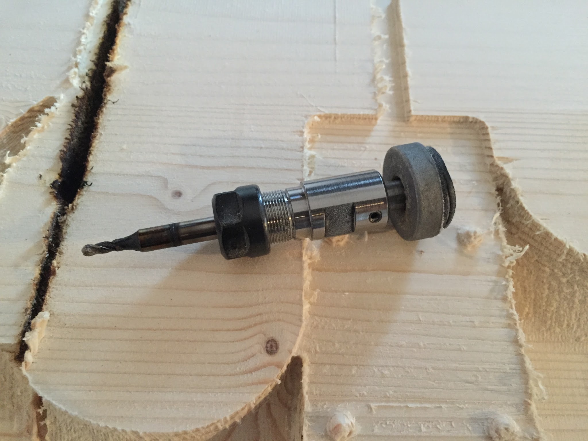

CNC-ing my father’s Christmas present using a China CNC zone 3040 DQ 4 axis with 400W spindle.
Approximately 10 hours into the #Mach3 job it decides to ignore the gcode and tries to carve its way through the wood at a depth of 15mm with a ball nose bit with a working cutting depth of 10mm. Doing this not only wrecked the cut but my spindle. The entire bottom half ripped off (unsurprisingly). Z axis is grumbling too so not happy.
I’ve used the parallel port software since purchase as it was included on disk. This is the second instance of it “disobeying” the gcode and making a hash. This time it was something important.

Mmmm had the same thing happen to me a few weeks back. Nearly the same thing using LinuxCNC. Turned it all off inspected my rig for damage besides the job i was milling had a big gouge in it. After i got it all up and running again have not had a problem. Put it down to a very hot day 40+c, shed was probably a bit warmer then that so equipment may have been a bit warm. Here’s hoping.

Yes I’ve had this problem several times. On the Mach3 forum they warn you about external electronic interference - like fluorescent lights and motors.
Eventually I realised my problem was caused by my small dust extractor with an old fashioned brush motor. Static was building up in the extractor hose. I changed to my external dust extraction system with its induction motor - no more problems.

I have a similar machine, 3040Z-D500w. I am running the machine in a unrenovated basement, using a single extension cord (long) to power the PC, 3 fluoro lights, vacuum and the cnc. Dennis, thanks for your post, I am going to HD to get some 14-2 and wire the area up properly. I have had it miss code twice, but thought it was my Gcode error, as I re-ran the code, and the cut when perfectly. I had to slow my rapids etc WAY down tho. I should be around 3000mm/min but im down to 1000. Thanks!
My system runs in a shed with nothing else but itself (this includes lights, fans etc) so it has no interference locally that I can actually change (as its the computer and CNC machine). Simply switching to TinyG and Chillipepper so that it is reliable.
You guys all impress the heck outta me… I run a CarveWright so I can’t claim any DIY except for the techiques I developed LOL. My claim to fame is doing a lot of stuff that really stretches the limits of the machine’s designed operating parameters. To be honest, I don’t know G-code from my elbow! I wanted to chime in on the recent topic swing toward poor power supply feed and/or static build-up causing non-sensical fubar carve results. In short: yup. To Aaron Friend: if you run a long cord to power all that stuff, 14/2 may not still do the trick when it comes to heat via current flow… I think you’d be better off running grounded 12/3 so your worries would be over and done with. As for Dennis Keeling: my dust extraction is via Shop-Vac with a pick-up hood along the Y-axis. Again, I think proper grounding makes the difference here too. I had been experiencing unexplainable fubar instances and came to realize, due to fingertip shocks, that all that dry particulate friction in the airflow was building up lots of static. I actually ruined a $300 power supply board by arcing across terminals when examining for noticable cooked components. Ouch! when you can’t spare the money. My cure for that was to lay sticky-backed (to stay put) foil between the plastic airflow ducting components on the machine, run to the machine’s ground, to vent static before it could build up. I also removed the 2-conductor power cord from the vac’s supply side and replaced it with a properly grounded 3-strand. Never had a problem since. To all: super great job of offering tips, guidance, help and advice to others… Great vibe here!
