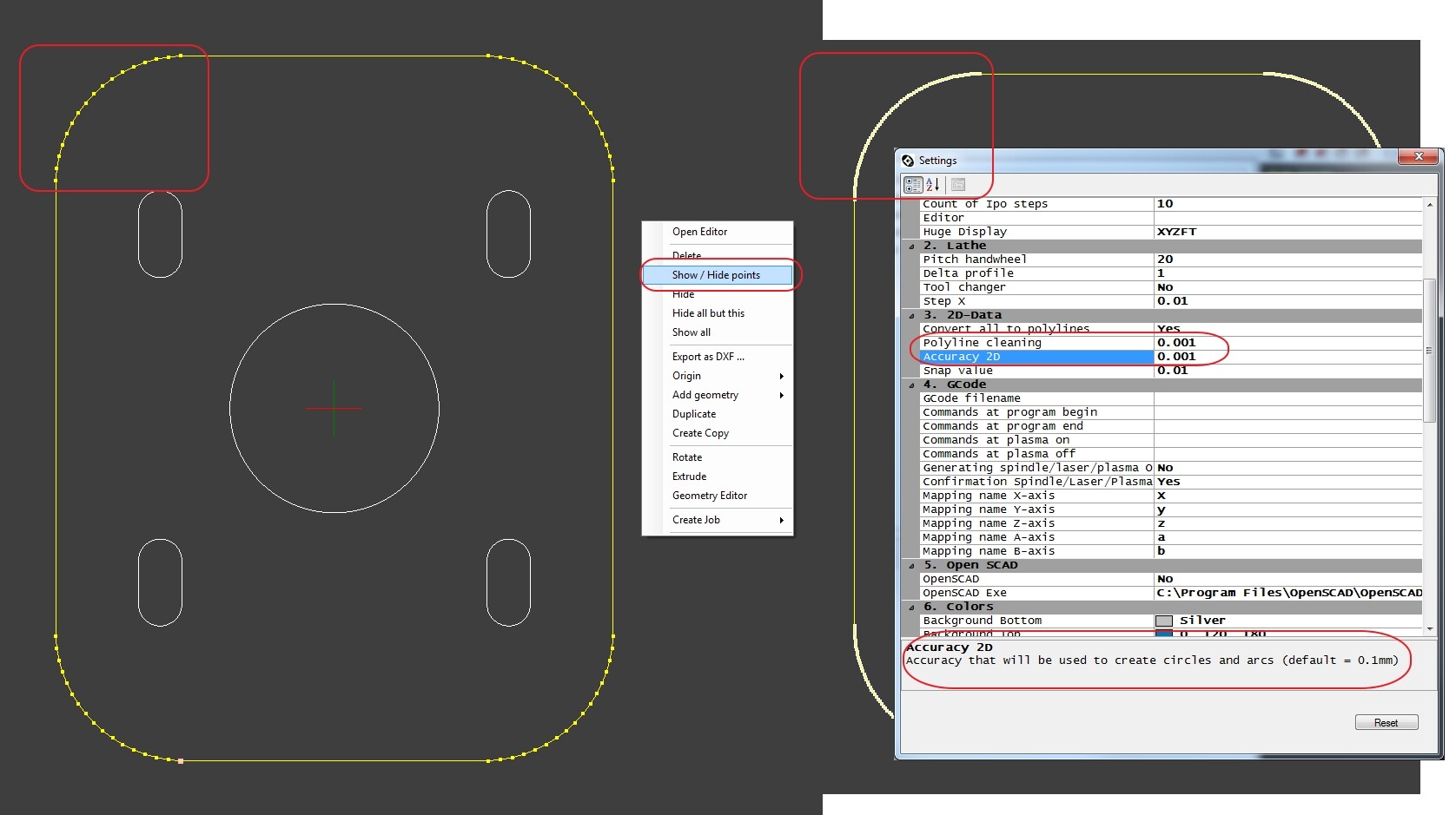

When I read in a DXF or SVG file, I convert all the individual geometric objects (straight lines, circles, arcs, etc) of a path into a polygon curve.
This consists only of small straight line segments. This is done because ramps and tabs have to be built into the path in the further course. Also the tool radius compensation needs a cluster of points.
You can display the size of the segments. Select the path and choose “Show / Hide points” in the right mouse context menu.
If the default settings are not ok for your application, you can change the number of points in the settings with the parameters “Accuracy 2D” and “Polyline cleaning”. “Accuracy 2D” indicates the maximum allowed deviation from the original curve. The smaller the value, the more points are generated.
Changes to the values will only take effect when reloading.

When i change “Accuracy 2D” and “Polyline cleaning” i can’t see any change in points and the g-code file before and after is same number of code lines. Don’t know about it should make the code shorter or??

I haven’t tried the new contour yet. But i am gonna try it out. Shouldn’t the g-code file be shorter if i change the settings polyline cleaning and accuracy 2D??
I have saved the project and x5 settings.
maybe the curves is just to small. when i see other running grbl it just looking more smooth than i can get it. Can’t see any change when i change the settings…
