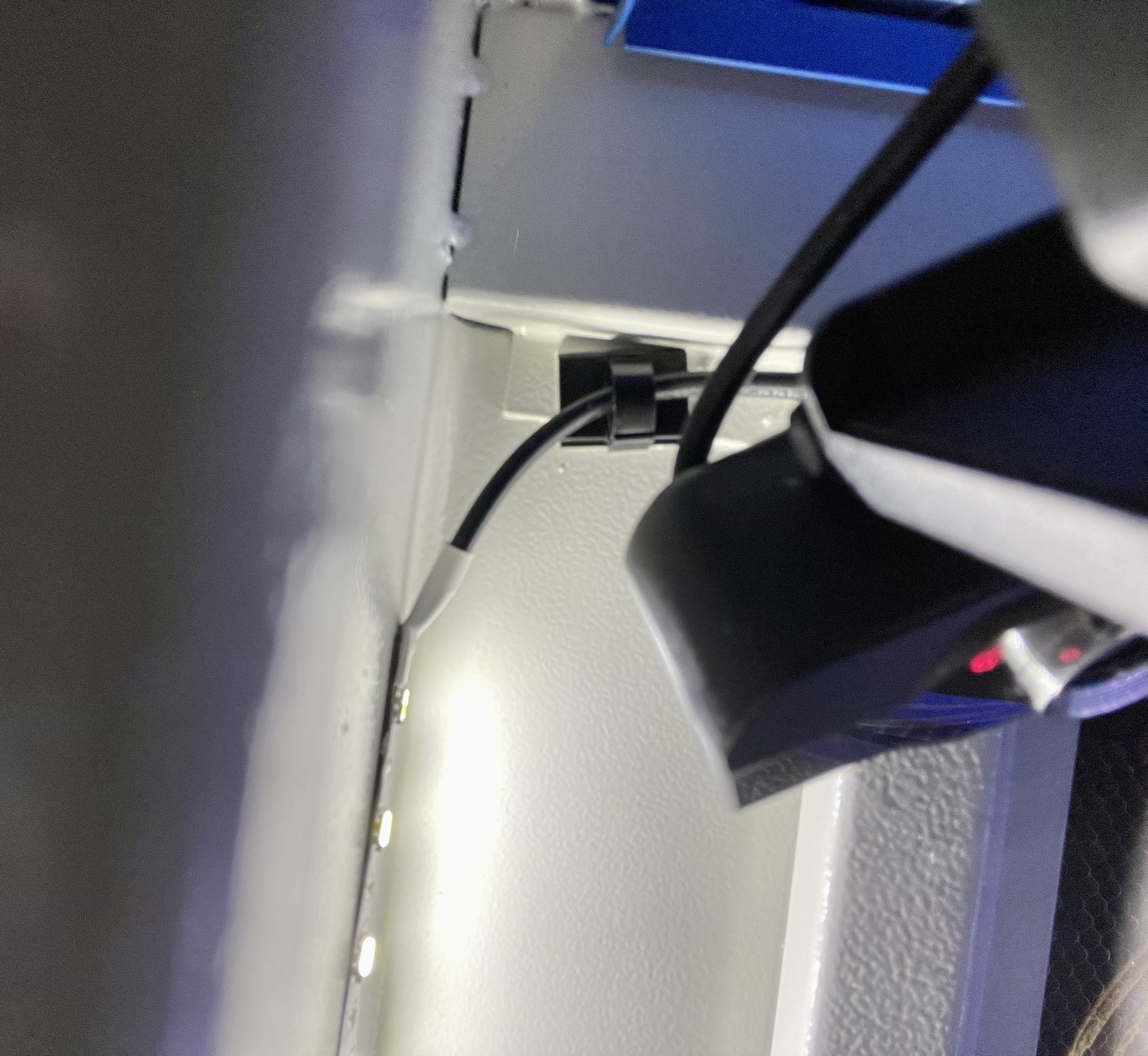

Will that camera work with cover closed?
Yep, clears the lid just fine.
Lid Closed
Did you know that LightBurn is implementing a calibrated camera system for laserhead mounted camera? Oz has implemented a bunch of it already and had posted a video to the LightBurn Beta forum.
The calibration process is a bit tediously long since head mounted cameras have a small view of the work area but with some of the options for USB cameras being quite small boards/lens/sensors the added weight shouldn’t effect performance much.
I forget if LightBurn releases the camera device after startup so it might be a moot point if they don’t since you won’t be able to monitor during operation. Something to keep an eye out for though.

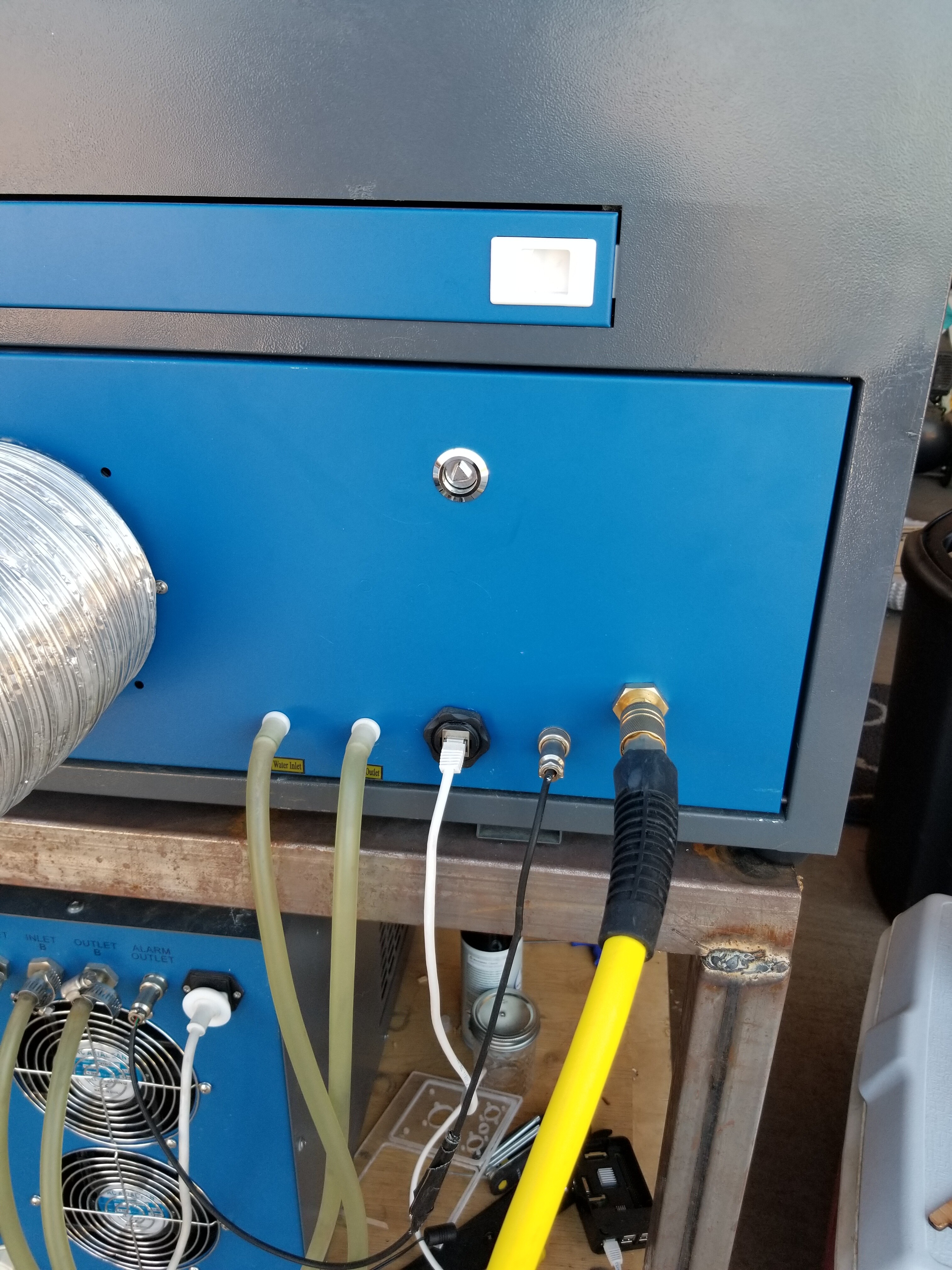

Noticed it has the left side access panel. It’s a real pain to get to the m2 assembly without that access panel… mine was a 2021 year model and it had a door…
I was wondering about the the location of the vent… mine is on the rear panel… The coolant ‘switch’ was mounted near where the coolant goes in. Do you have a separate panel on the back? I assume too boring to post… lol…
Mine came with only a water protect and door open sensor. Turned the door sensor off first day I got it, removed the water protect and wired it to the chiller.
The lps came with a digital mA meter, jumped all over… I added an analog one… Have Russ Sadler tube mount, requiring an extension. The BNC output are used for the scope when I’m looking around. One is pwm output, currently the other is across the mA meter.
Had the same issue with mine when new, the pump and vent ran all the time. Replaced them with a SSR, cheap and dependable. Draw much less current than than solenoid type and more dependable.
I have the SSR connected to ‘Status’ on the Ruida, along with low pressure air solenoid. High pressure is selected when ‘Wind’ goes low and the other solenoid bypasses the low pressure restrictor. Noticed you have ‘Aux Air’, probably the same sink as wind.? It is nice you can turn it on and off via the front panel.

Lightburn has a camera interface that’s pretty slick. Not the new one referenced by @dougl. You can use it to re-align a part if you move it… or align your graphic to the part…
https://lightburnsoftware.github.io/NewDocs/UsingACamera.html

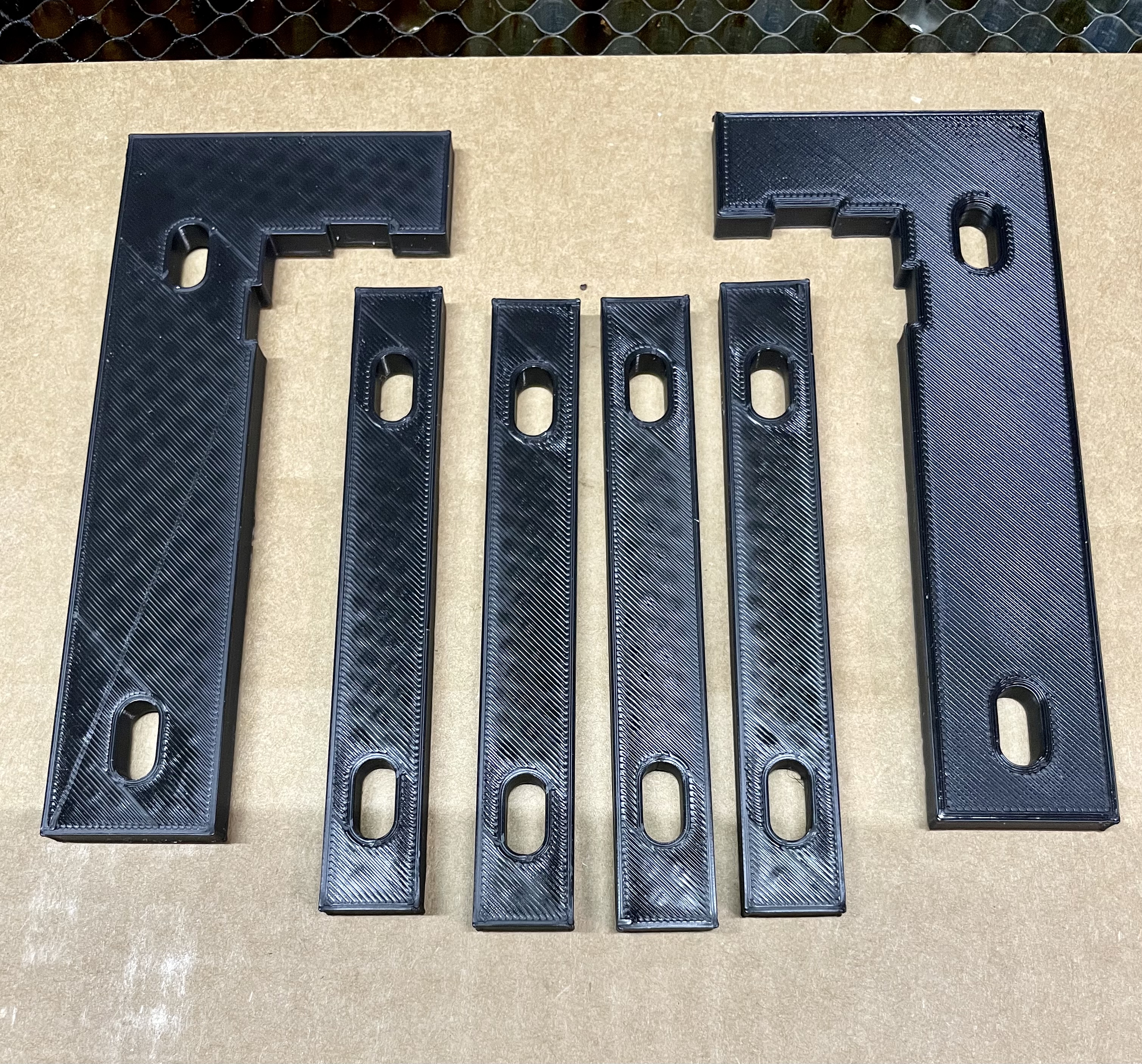

Finally got around to designing and 3D printing some brackets for the honeycomb bed for this 50W laser. The honeycomb bed just rests freely on top of a knife bed and can shift around. Had been using some magnets, but it could still shift some and wanted something more fixed.
The hook shaped ones go in the back corners since there is nothing really to screw a bracket onto in the back. Also the notches on the inside corners were there in case I needed to clear the pop rivets on the corners of the frame. The bottom side brackets are probably overkill.

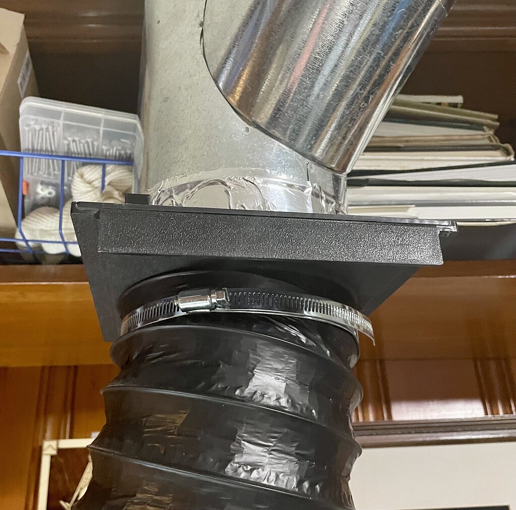

Added an eye level exhaust blast gate position indicator.
