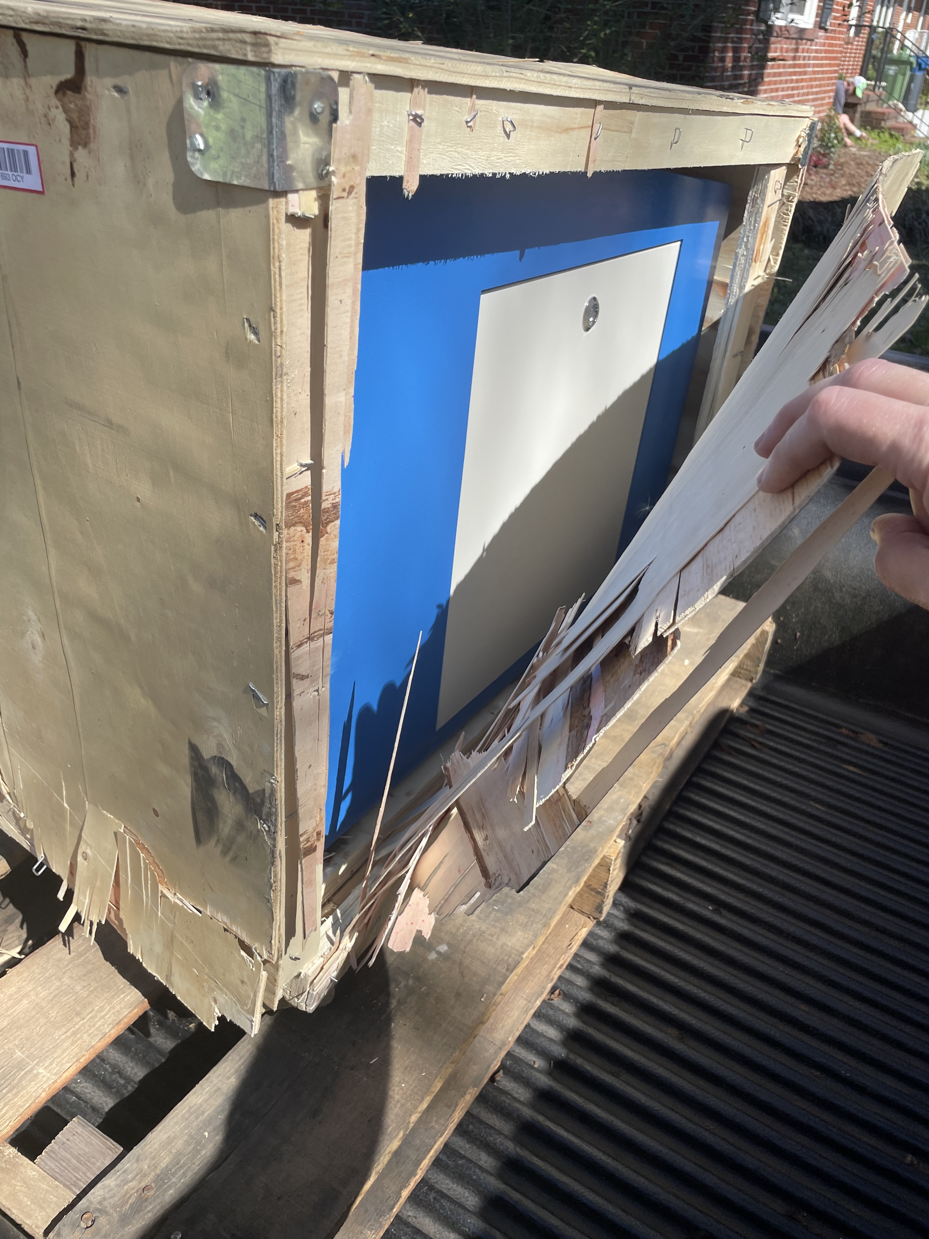

So the new machine arrived a couple of weeks ago with one end of the crate cracked open. :grimacing: Visual inspection didn’t show any damage to the machine fortunately. :sweat:

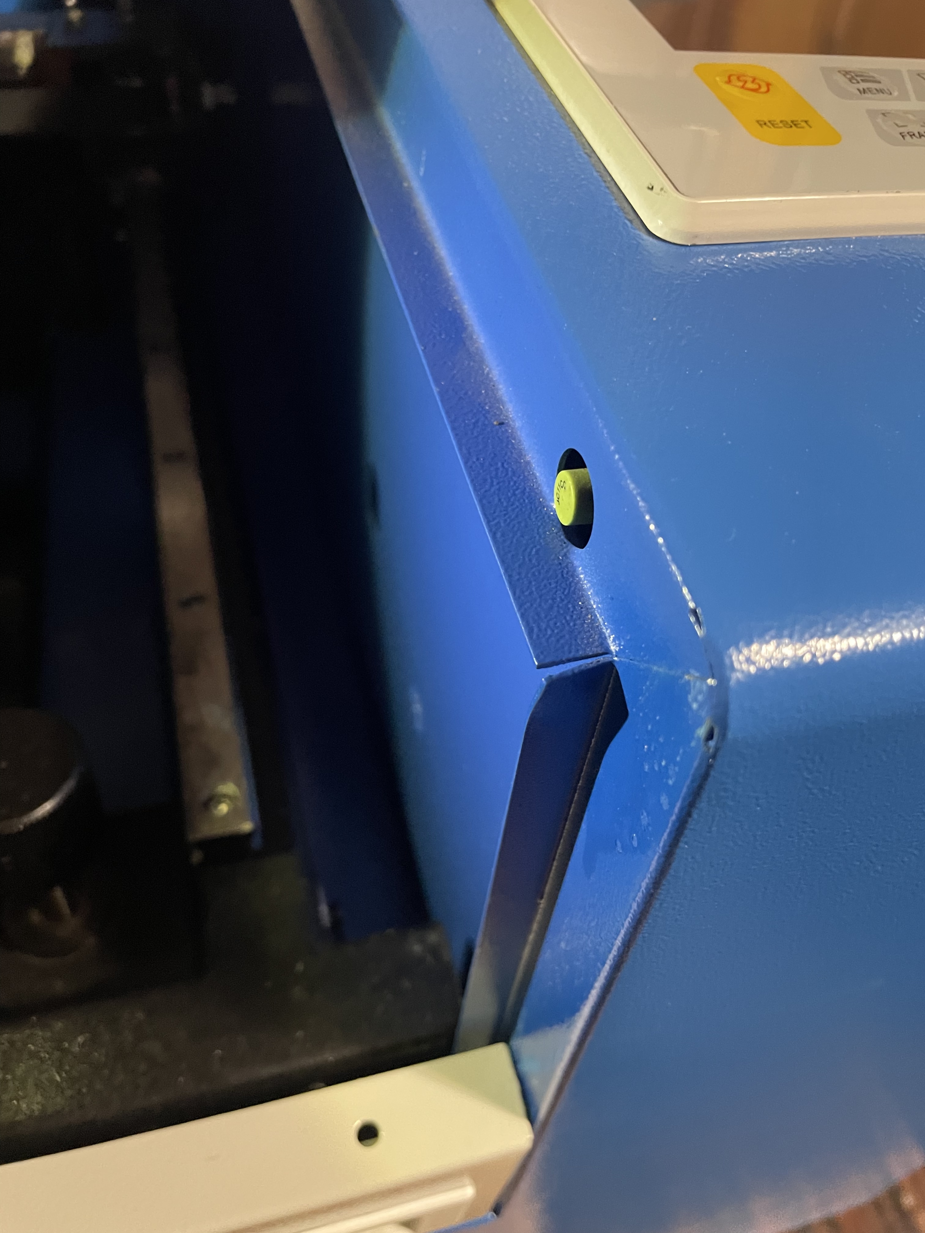

I cannot resist: “Interlocks”!?
Lol, sorry I forgot to comment on interlocks. It appears the lid does have some kind of non-contact sensor.

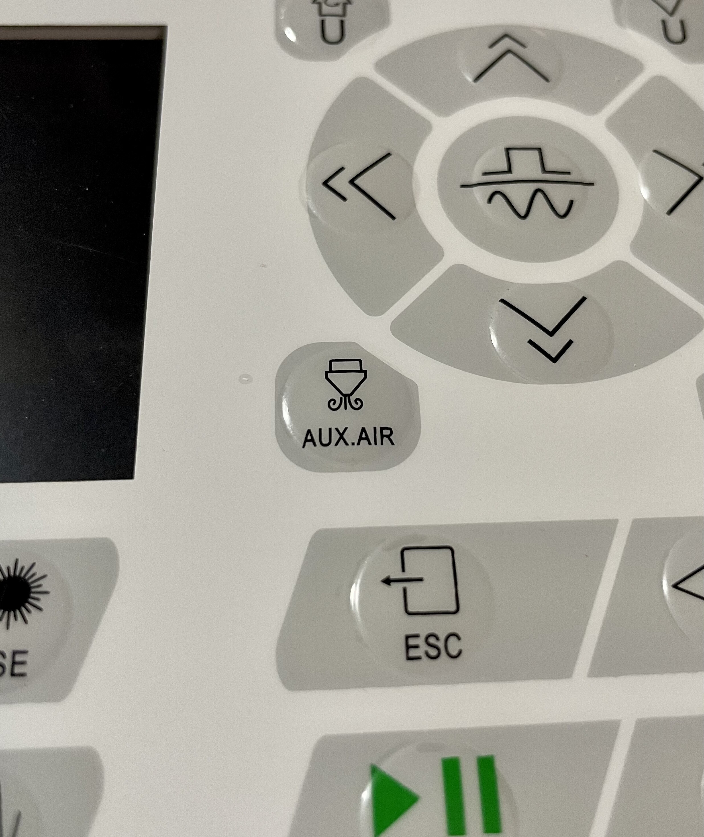

One thing I don’t like is that the built in air assist pump and exhaust fan are always “on” when you turn on the machine. No way to turn them off without turning the machine off.
The controller panel does have an Aux. Air button that does nothing.
Which is because nothing is connected to the pin out. :frowning_face:
Easy enough to fix I suppose. Ordered a 24V relay and hooked up the leads for the air pump and exhaust fan to the NC side of the relay. Connected to the Aux Air and +24V pin outs on the controller to trigger the relay.
Success. :tada: Looks like I can automate turning it on and off when lasering through the controller itself or LightBurn.

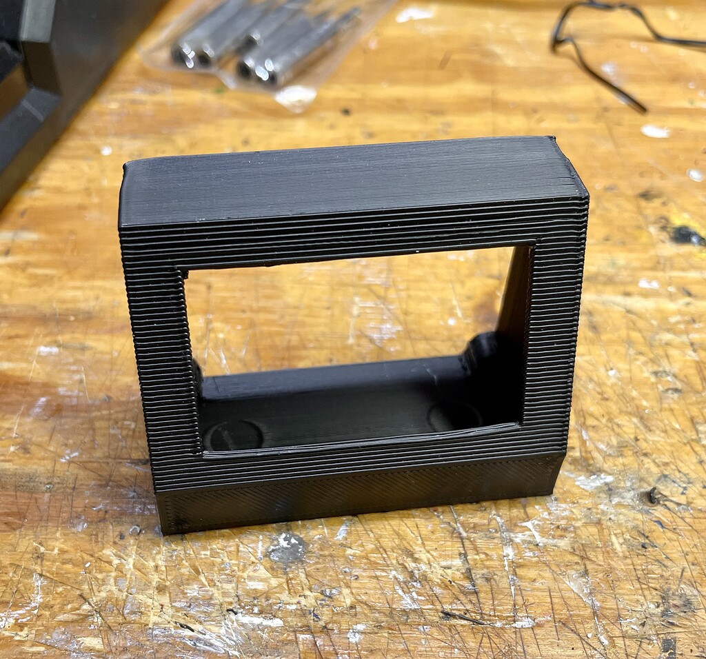

  • Because the 50W sits up so much higher than the K40 I wanted to add a webcam so I can easily monitor the bed from my computer.
    Found a very cheap webcam that had decent reviews. The only negative for the webcam is that the cam sensor is kind of of noisy. But for the price it’s a great buy, especially if you are using it to monitor something.
3D printed a small riser stand that would accommodate a 1/2" 1/4-20 attachment screw and some 3 x 8 mm Nd magnets
Attached it to the gantry frame in the front right (Note, I removed the cam from the mount and rotated it 180deg.)
