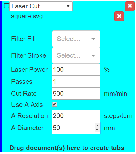

Notes for anyone who tests this. I don’t know if Resolution needs steps or usteps (M92). Resolution and Diameter are for the roller, not the stock you’re lasering. If you want the drawing to wrap all the way around, then resize it so its height matches the stock’s circumference.
Probably nothing big, and likely because of something I’m missing, but why are there 2 red ‘X’ on there?
1st: delete operation. 2nd: remove document from operation.
