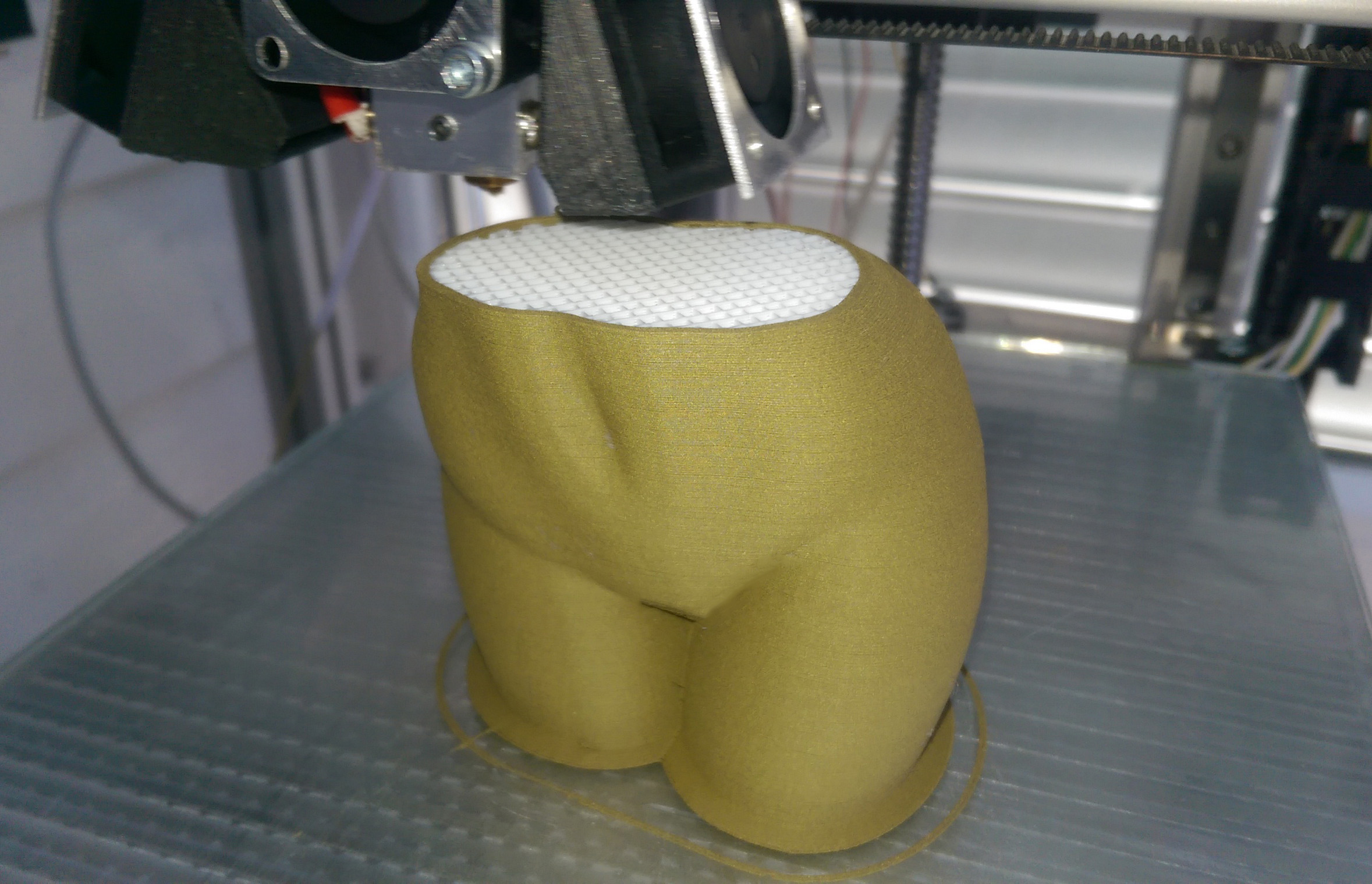

Colorfabb BrassFill with normal PLA infill for cost reduction and better structure.
5 hours to go :slight_smile:
Here is hoping that none of your infill shows through the wall or oozes on you.
Plenty of perimeters and an ooze shield would solve those if they are an issue.

Jeez… Make her hollow and fill with dirt cheap expanding foam.
@Griffin_Paquette dual x carriage
@Kura_kuea yep. 3 perimeters were not enough where the angles were too steep. next time i’ll do 4-5.
