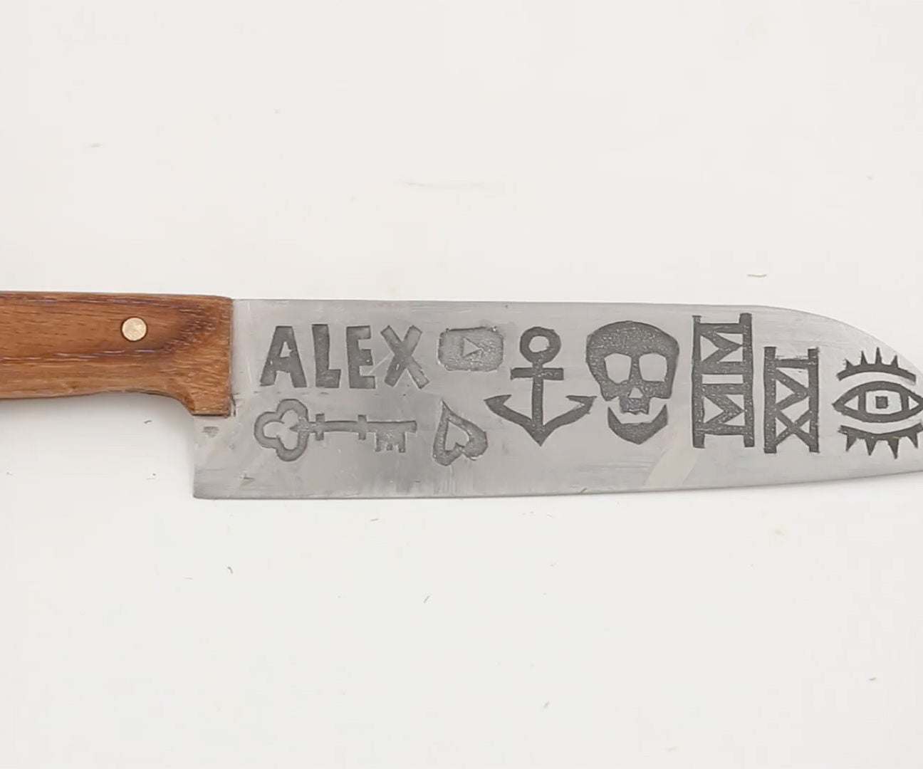

I would add a 3rd way to etch metal
in step 1 in this instructable use a k40

On the etching, with the 9V battery he was limited by the battery capacity. Higher voltage will drive the reaction faster. You just don’t want to drive it too fast. I’ve seen people take wallwart charges and use them for etching.
@Nedman That would be great if you can reverse engineer it. Reading through the Thermark article you shared gives a vague idea of what way to go about it, as they suggest their product utilises pretty much the same standard ingredients that are in pottery/ceramic glazes for colouring. Not 100% sure about the special “absorber” components though, that’d be the hard part I guess.
I thought the battery capacity may be the issue with the etching, hence I was considering a charger of some sort. I imagine 12v charger would be a reasonable speed & provide a continuous source. Looks like a fun project to test sometime.
