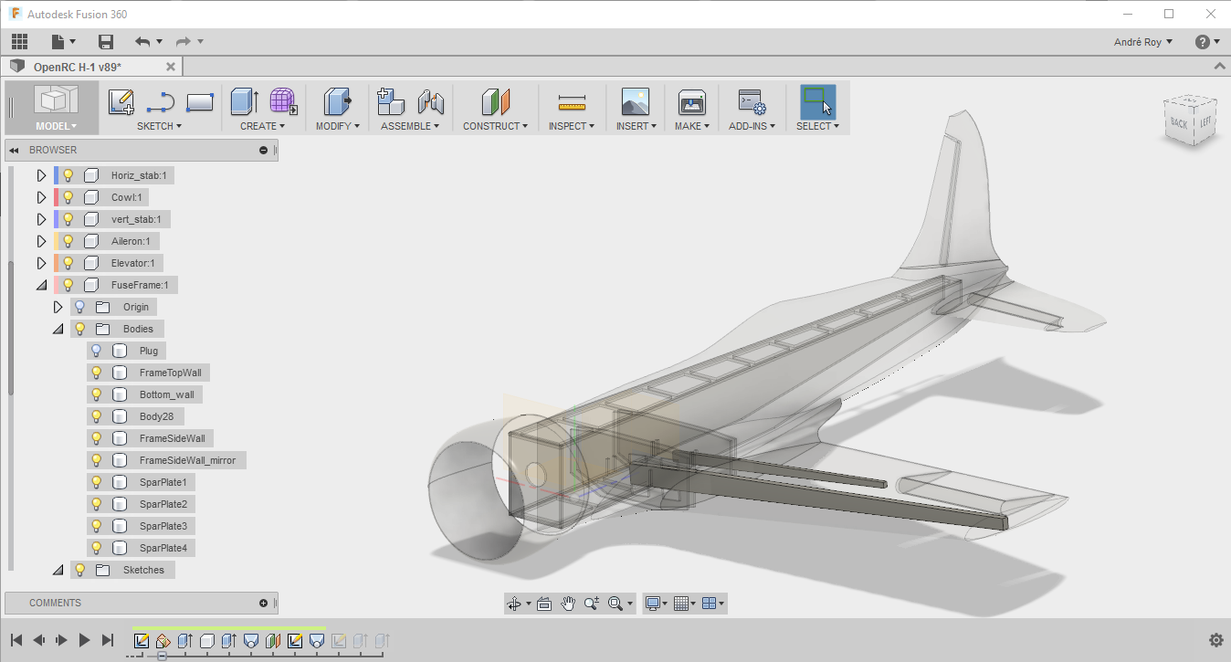

Completed a first stab at designing the wing spar (shown solid in the attached screenshot). The main spar will be made of three layers of 1/4" laser cut plywood laminated together. The trailing edge spar will be less hefty. Wing is designed to be removeable by sliding the spars into slots in the fuselage frame.
This first engineering challenge (spec’ing the spars) is complete. These spars are designed to handle 6Gs (10kg plane) with a safety factor of 1.4.
