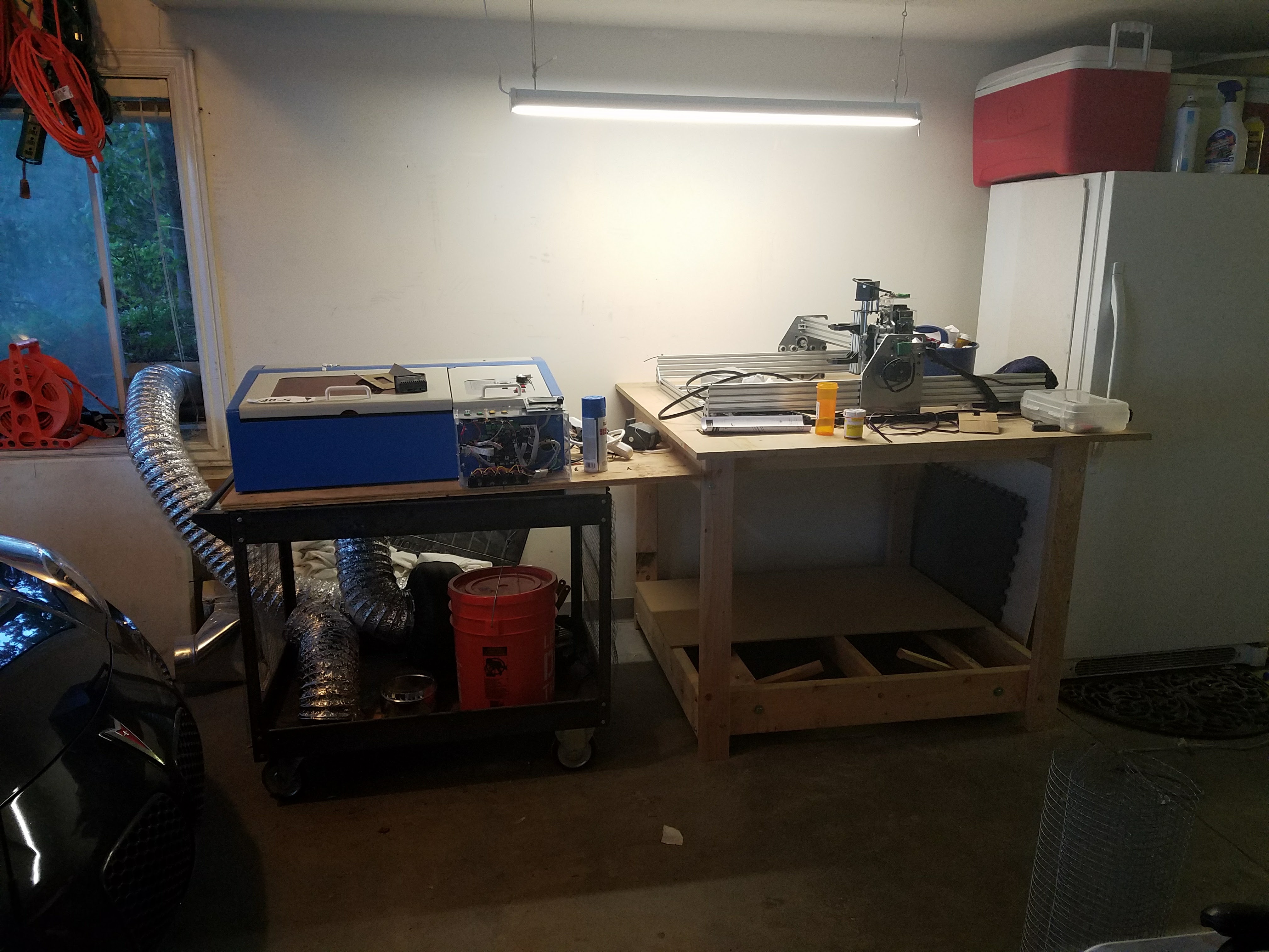

Completed most of the DOX table build.
Now all my CNC builds are in one place, on mobile tables and down in the shop.
A main feature of this table is the integrated lift. I wanted to be able to move it easily, yet still be strong and rigid.
The integrated cams lifts the table 1/4-1/2" up on casters so that it can be rolled to a place where it is then lowered.
Next, making space for the PC and then wiring!
