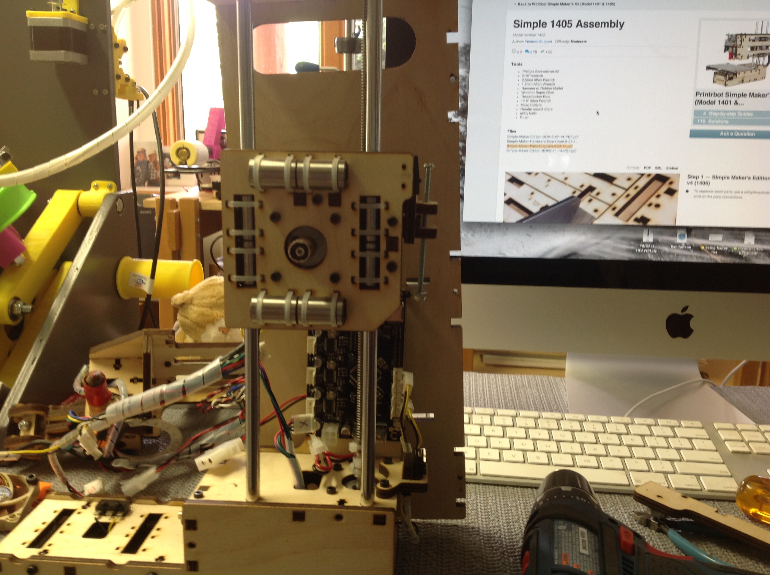

Completely disassembled my Printrbot to update to 1405 version.
Completely disassembled my @Printrbot to update to 1405 version. Got to step 24, assemble z axis and find there are no set screws in the coupler or anyplace else.
The coupler wasn’t machined with the spiral cut either.
Argh, no printing until this gets straightened out.
