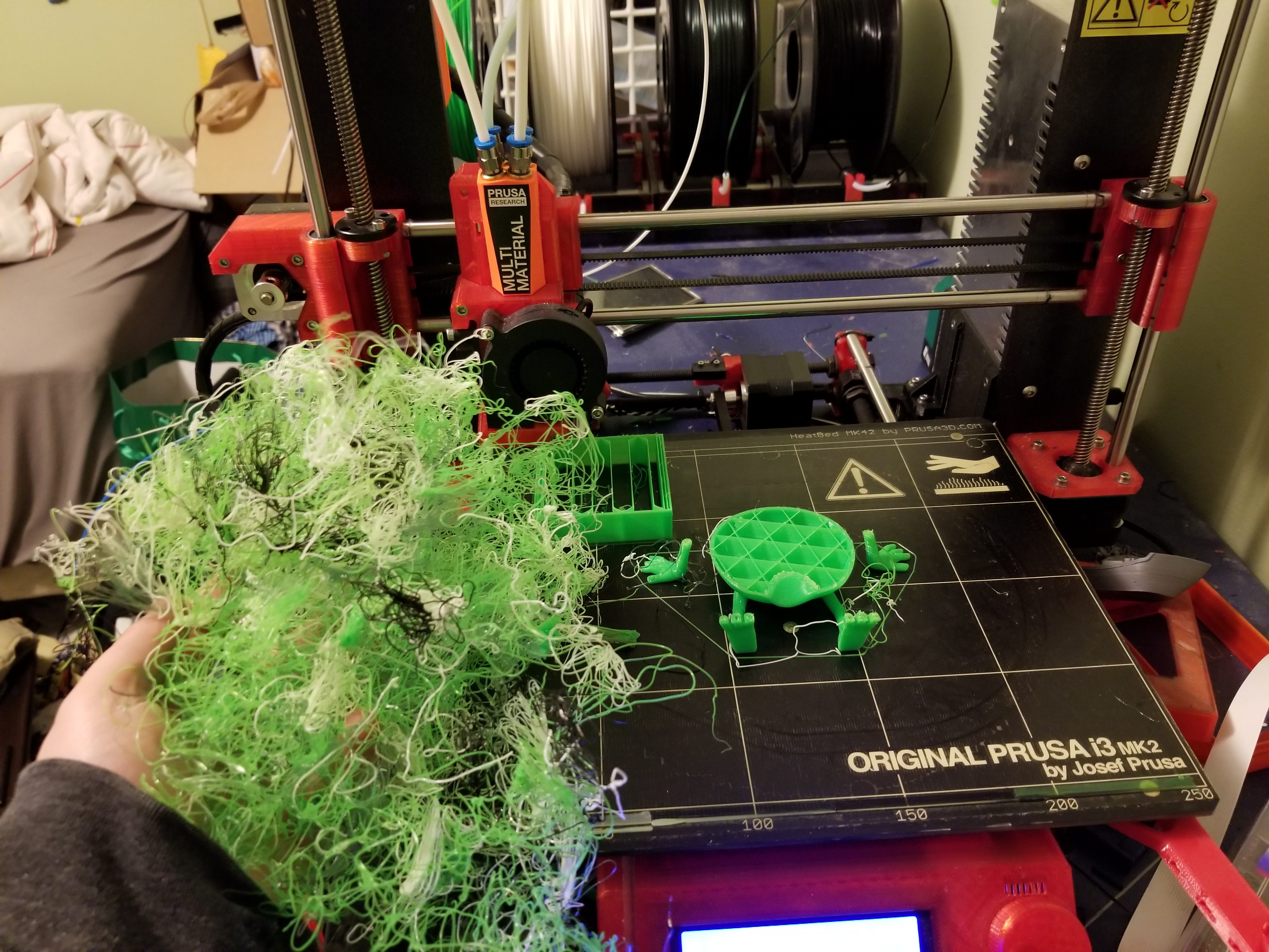

Completely forgot to check on my 13 hr print while it work :/

Better than my average failure, where it builds up on the head and creates a huge blob which is impossible to get off cold
Looks like the curse of the green ABS to me… Seriously now, what are you printing in?
Looks good, but you might want to reduce print speed a little for greater details on your birds nest.

@Duncan_Gunn PLA. Been having a bit of issues with this brand with the multi material setup, mostly with small stringing. I’d have switched by now if I wasn’t getting the filament for $15 per kg.

@Adam_Steinmark I had a lot of trouble with PLA of the exact same colour, literally. To be fair, most of my problems were caused by my having a rubbish hotend that I replaced with an E3D V6. Did a part become detached or did your extruder temporarily stop?
@Duncan_Gunn I wasn’t home to watch it, but what I believe happened is a blob formed on the end of the filament which prevented it from being inserted. Then when it cycled back to the light green filament there was enough momentum from it moving after retracting above the Y splitter to force it through. It’s happened a few times, sometimes it skips steps then works fine. I think a big part is the friction and moment forces on the filament due to the multi material upgrade. I’ve been meaning to add a feed tube all the way from the spool holder to the extruder to help keep the feed more consistent and ensure more even flow. I’ll probably just replace all the bowden tubing with Capricorn tubing.
