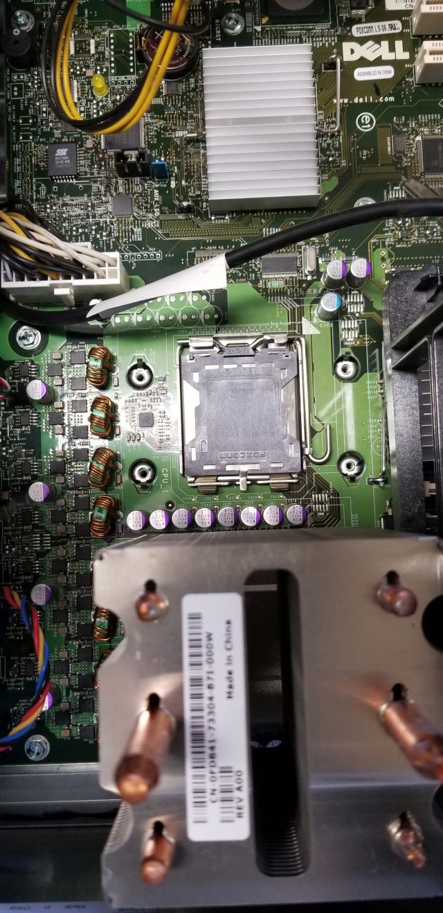

While taking the computer apart to clean it and blow out the dust, I got a wonderful surprise. There is a second socket for another CPU. I just happen to have another CPU that fits. I cleaned and refreshed the heatsink grease on the original CPU and installed the second CPU from the donor computer. I also installed the additional 16 GB of memory. Crossed my fingers and booted up the computer to see a wonderful screen showing two CPUs and 32 GB of memory. The video card is an ATI Quadro FX 4600. After all these years it is still averaging $100.00 and still available. So for a total investment of $55.00, $30.00 for the two computers and $25.00 for a SSD drive, I think I have a bargain on my hands.
