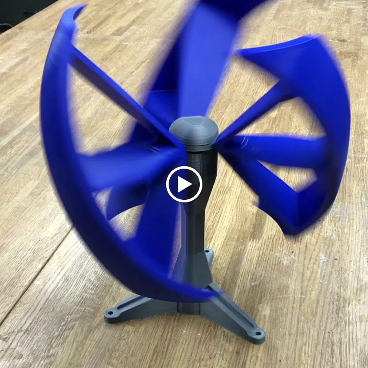

Concept #1 of a 3D printed vertical axis wind turbine. #morrisontech

Cool!..what are you using for the bearing(s)?!
@Fook_INGSOC We had an thread rod and some bearing left over from an old cupcake 3d printer. the thread rod is 1/4 dia and there is two bearing one at the top and bottom that measure .875 od resting in the 3d print.
