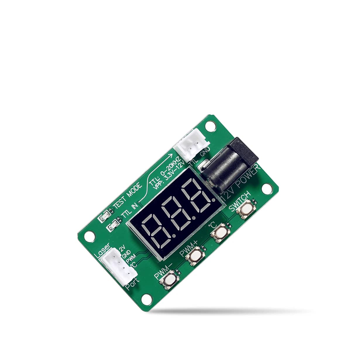

BTW I found this module from NEJE [who are fast becoming my favorite laser vendor].
I am thinking about adding it in series with my laser to measure temperature, voltage, and PWM.
I have not yet evaluated it so I do not know if it works as advertised or if it has any compatibility problems.
Depending on the laser’s interface you may have to modify the connections.
I am also not sure the temp measurement is compatible with non NEJE lasers.
I’m also looking for some better documents on its operation.
It worthwhile to do a NEJE keyword search on Amazon.

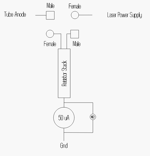

@donkjr got my high voltage meter installed… still isn’t finished, but working.
Meter…

“… got my high voltage meter installed…”
Be interested in how you implemented the hv meter.
Spoke to @mcdanlj about it and he advised I put it up when it’s working. But it isn’t completed.

What I was saying was to post publicly rather than in DMs, finished or not. I’ve posted lots of projects under constructions. Some have been failures. :relaxed:
Sorry, it wasn’t finished, so I was dragging my feet. It hasn’t gone up in smoke, but in reality it’s a resistor with a meter to ground. How complicated could that part of it be?

Does that mean that one side of the meter is at HV?
No, the meter is between ground and the low-voltage end of the HV resistor stack. The neon bulb is so that if the connection between the meter and ground is interrupted, the low-voltage end of the HV resistor stack stays reasonably low (~90V) instead of ~20,000V
Exactly… the theory…
