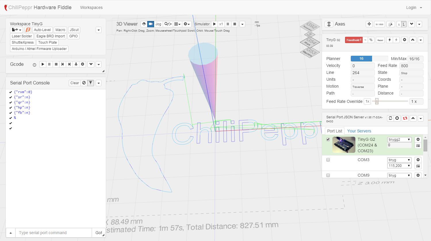

Homing and probing successfully tested using Chilipeppr (http://www.chilipeppr.com/tinyg?v9=true).
