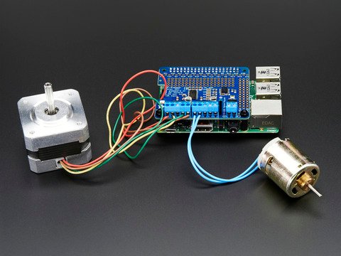

First, seems we can buy boards to stack onto a Pi that control stepper motors over the I2C interface, with relatively high level operations that take us away from “hard” real-time. Examples include:
Adafruit DC & Stepper Motor HAT for Raspberry Pi
MOTORplate
Each of the above controls two steppers, and costs ~$20-30. To do XYZ and one extruder, I need two boards. If I want a second extruder, and perhaps fan control, then I need a third board. Right.
Frankly, I will likely just buy a stack of the above Adafruit boards. Though that would limit(?) to 12V motors and fans. Maybe not enough power?

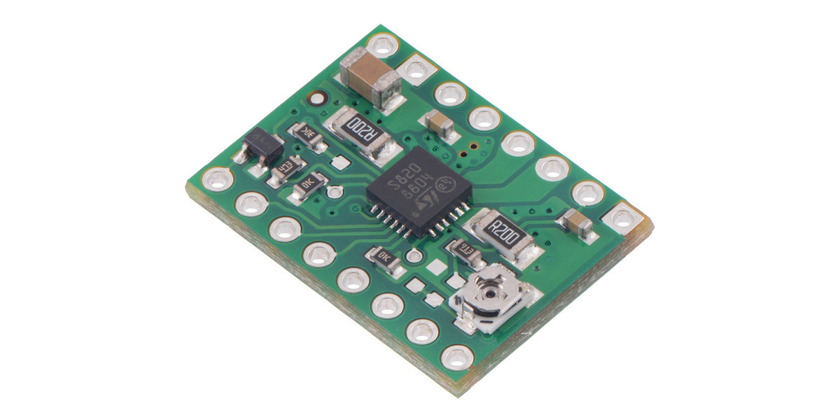

SilentStepStick TMC2100 5V Stepper Motor Driver
The cost looks to be about a wash. The above shield looks able to drive motors at 24V (or higher). The software … and this point the rabbit-hole becomes deep. Not sure how much trouble is there.
